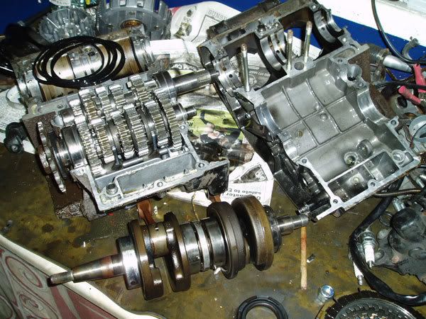

  5. wobbly_trials
    Like that (350 ypvs)
  6. the eel
    the eel New Member
    210
    Looks swampy.
