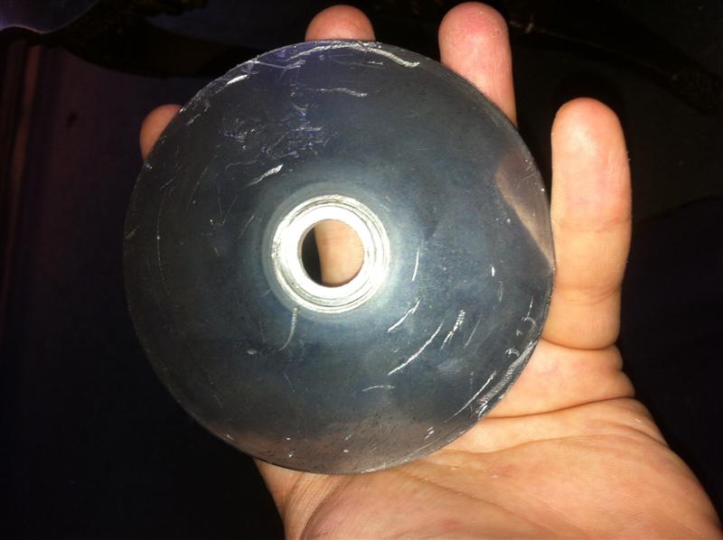

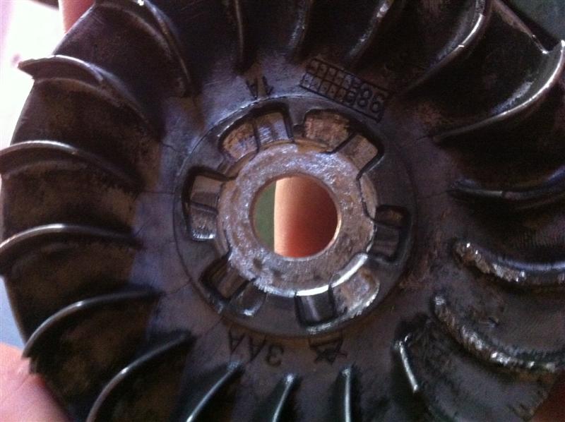

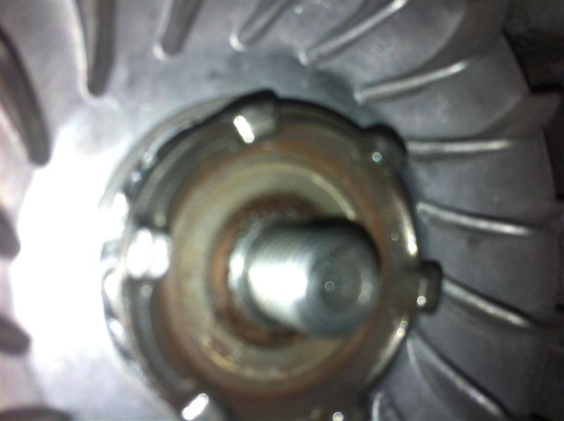

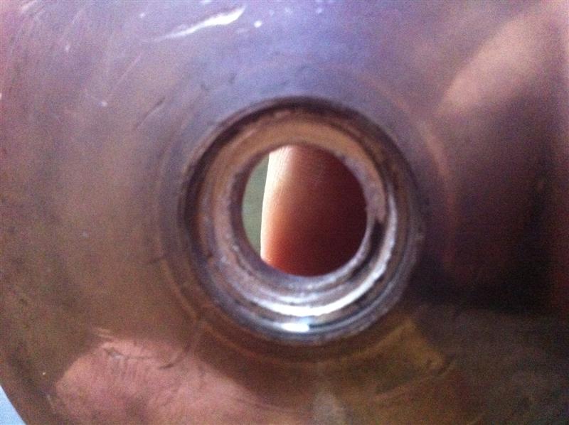

    Just checked my old variator face plate to see if there was a washer stuck inside where the sleeve goes into it and i was abit shocked by what i saw.
    I knew what happened to the front and the scratches at the back that was the reason i replaced it but never checked the the recess.
  3. Merlin
    Merlin Old School Biker
    2,305
    2007 TKR WRC 50
    Those parts are comprehensively f*cked (technical term).

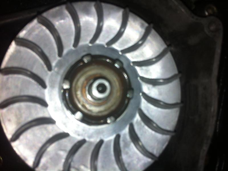

    Hi guys a little update, have put variator shims behind my front pulley plate needed about 1.2mm i have no idea what happen for it to get that way have got a couple of pics before i put the shims in.
    Sorry about the quality of the pics.
