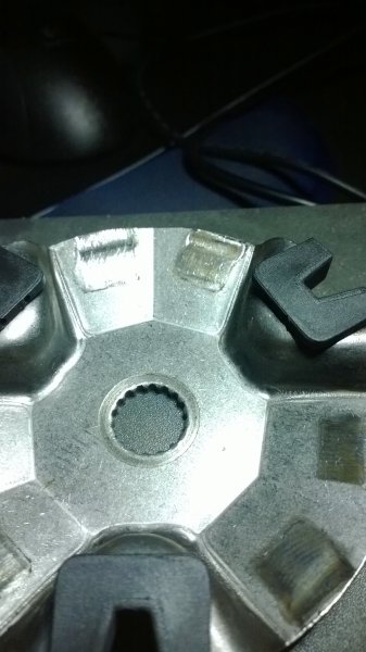

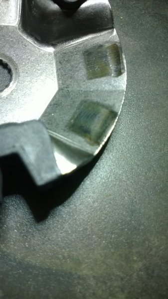

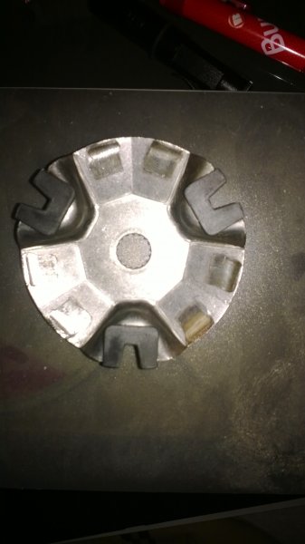

    Here are the pics I promised....
    I don´t know if this is what you´d call normal wear? I think, in my inexperienced opinion,that this plate looks like it´s been to the moon and back;).

  8. Merlin
    Merlin Old School Biker
    2,305
    2007 TKR WRC 50
    That looks knackered to me, but I'll see what the other knowledgeable peeps think on here.

  9. southweezy19
    405
    yamaha neos!!
    Bloody ell mate you got any pics of the old rollers? be interesting to see. yeah I'd say its nakard putting new rollers on that worn surface will wear them in no time I reckon
    JoolsG likes this.
  10. Stevep
    Yup, shot. Polini/Malossi replacement please. You've got to change it so may as well be a good one. And the price difference between standard and upgraded isn't that great, so it's worth it.

  12. JoolsG
    JoolsG Active Member
    210
    Yamaha Neo´s 50
    I´ll make some pics of the rollers, but amazingly the old rollers don´t have any flat spots on them (I think they must be made out of kryptonite ;)).
    Even though they looked ok, I replaced them with 5.5g Naraku.
    The old one´s weighed in at an average of 4.75g, (I bought a little scale from ebay to weigh my airgun pellets so it can weigh down to 0.01 of a gram.
    When I replaced them with totally fresh Naraku rollers and after 2 days my problem was back, I decided to check the variator again and 3 of the naraku had flat spots on them, so I then mixed 3 of the old one´s which weighed in at 4.75g(average) with the remaining 3 Naraku. The scoot ran very fine after this but on the second examination of the variator I really noticed the roller plate damage. I ordered a new one and replaced it 2 days later and now my scooter is driving like a dream.
