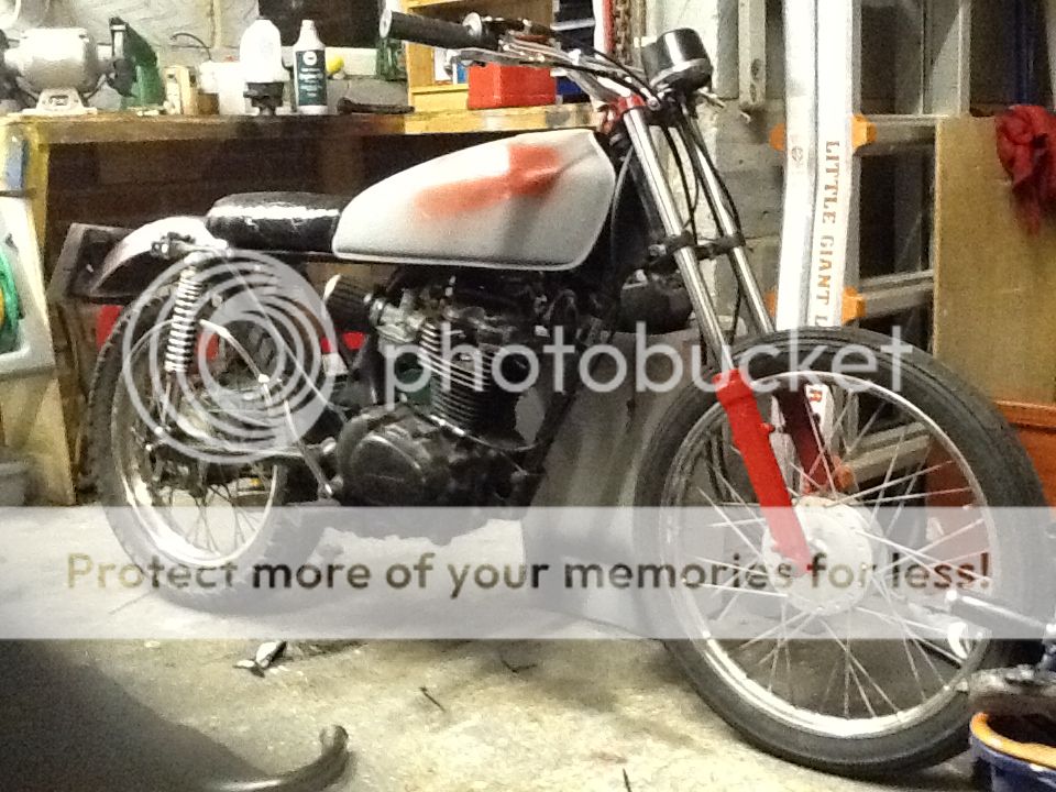

    Brought home the painted bits from work, so I got a bit done.
    Thought Id get some pics of the frame modification I did before painting it. There used to be a huge airbox, and I'm gonna have a nice little foam filter so I got rid of it. That left a load of ugly mounting brakcets, so I drilled out the spot welds and cleaned it all up a bit. The rear of the frame looks nice and uncluttered now :)
    So this is the summary of todays work;
    Hopefully the next few updates will show some decent progress rather than little bits.
    Hope you all like it.

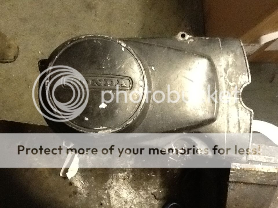

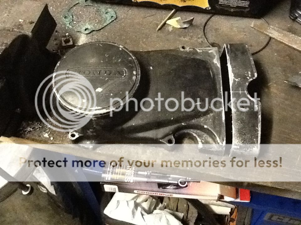

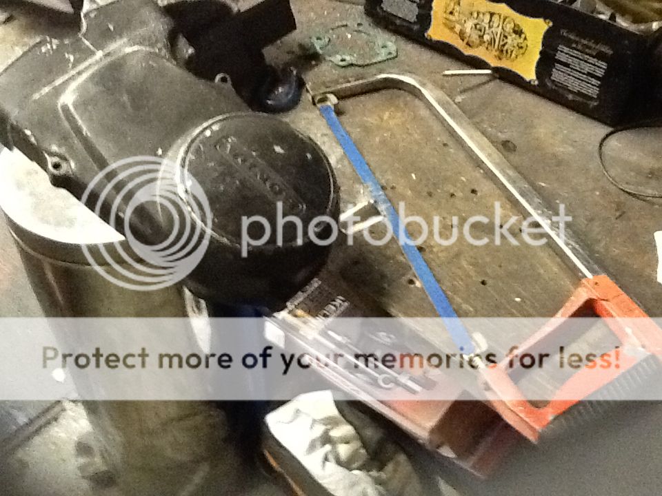

    Did a bit of work last night on the flywheel cover. Pics are self explanatory really, just made it look a bit more in proportion.
    Might seem a bit odd bit it look really nice on the bike :) bit more of a motocross theme really, rather than having loads of the chain covered up.
    Found another pic of it from before too

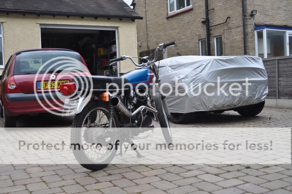

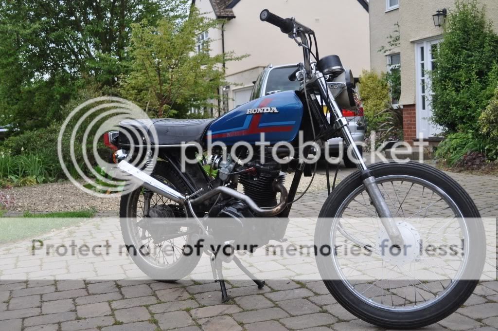

  16. FiddyRox
    FiddyRox Well-Known Member
    1,112
    Aerox, CRF450, YZ125
    Now in the garage instead of the shed, it's moving up in the world.
    Modified and heavily cut-down mudgaurd, made from a standard replacement
    New Headlight and indicators, i've now deceided im not gonna run indicators though
    Relocated original ignition barrel, used to be at the front of the bike. Wiring loom looks all messy but thats because its just loosly laid out (built from scratch)
    Custom carb setup, 28mm flatslide with custom manifold
    Thats it for tonight ;) Bike still looks a bit shitty but thats only because its being all built up and then stripped for paint and powdercoat.
    hope you like it, about time for some new pics!
