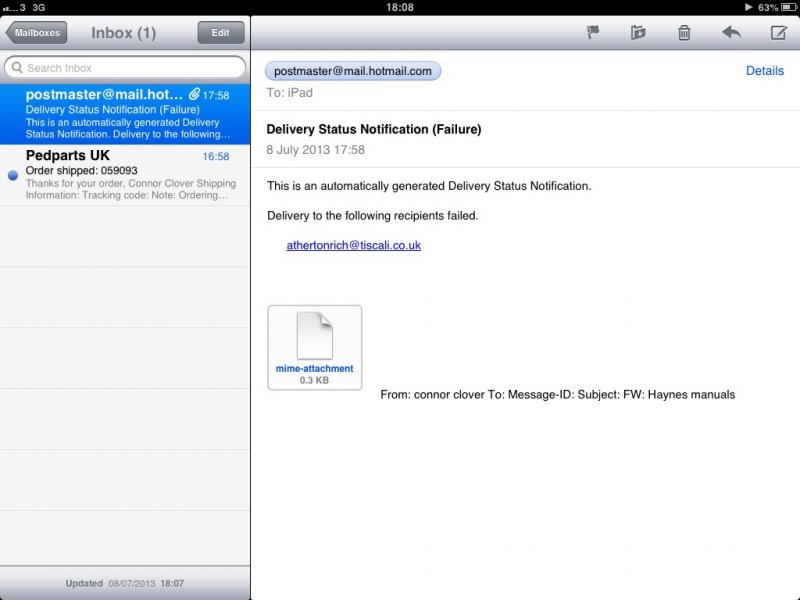

    It's automatically failed :confused:
