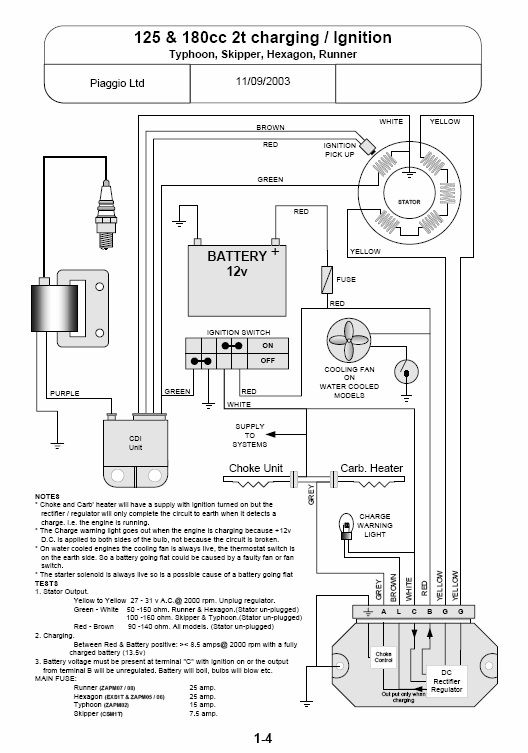

    The next bit you need is on page 14 of this document, download this as you may find other useful stuff in it:
    http://www.aonsc.co.uk/pdf/vespa-workshop-notes.pdf
    Piaggio and Gilera share a lot of parts between models. This is page 14, anyway.
    You need to unplug the stator wiring at the multi-plugs and set your meter to the 'Ohms' or 'Resistance' setting. On some meters it is marked 'Resistance' and 'Rx1'. Put your probes across the wires as mentioned in the table marked 'TEST' and check that the readings of resistance are somewhere near those marked in that table, for each pair of wires. If one of the readings is not the same as that list then the circuit could be faulty. Don't connect the new CDI unit to the bike until we investigate further or you could end up with another knackered CDI unit.
    If all of the resistance readings check out, then the wiring and stator is good and you should be OK to connect the new CDI when it arrives.

    Do i need to remove my flywheel to unplug my stator? Also downloaded the manual above and page 1-6 or 16 says to test green and purple and 14 says green and white

    No, the multi-plugs will be clipped to the frame in front of the stator. You'll see a black plastic socket coming out of the flywheel/stator cover and the cable you want is plugged into that. Find the plug, work out what colour wires go to which pins in the socket and test the resistance via the pins in the socket.
    The socket is top right in this picture.
    SPRunnerSP likes this.

    im lost here :( dont no what im doing . where it says green and white, when i put it on resistance do i put the red prong on the green AND the black on the white ye??
  17. Merlin
    Merlin Old School Biker
    2,305
    2007 TKR WRC 50
    Yes, that's what you do. It doesn't matter which way round the probes are when you measure resistance, they only have to be the right way round for measuring DC voltage.
    Green and White should read about 100 ohms (50 to 150 Ohms is good). Red and brown should read about 115 ohms (90 to 140 Ohms is good).
    Take your time and you'll be fine. The important thing is to get the readings and compare them with the ones I've posted here. If they are within the ranges then your stator appears to be OK and it's the CDI that's likely to be at fault.
