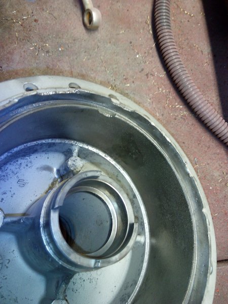

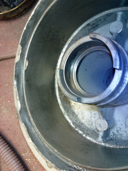

    Well now, seems I won't have to buy a new hub afterall.
    I think it's cleaned up well, very well considering.
    There is some pitting at the very bottom of the hub, but this area is very thick so shouldn't affect the integrity of the hub itself
    There is only minor pitting to the brake shoe surface itself, again, I've seen a lot worse on newer bikes.
    That little bit of roughness may even help with the braking efficency.
    And that ragged edge has now gone. Nothing that a big flat file couldn't sort, I'm not too fussed about losing it.

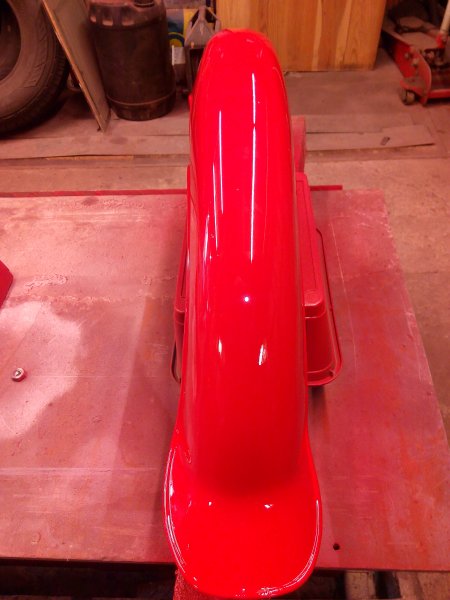

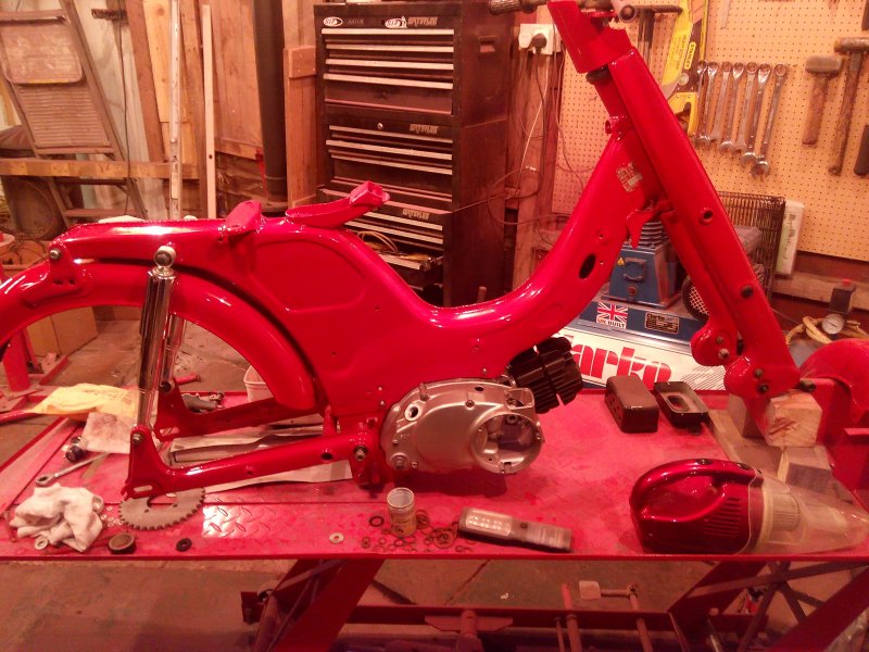

  10. Stevep
    YAY plasterers finished, looks sooo much better now.
    While he's been doing that, I've been doing this:
    Bit of dust over it:rolleyes:
    Painted the front and rear mudguards
    Moving along slowly
