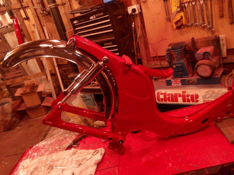

    It's getting there slowly.
    Once I've got the main stand painted and dried, I'll start building it up on the far ramp, you can see it in the background in the swingarm photo.
    Can't decide whether to paint the shock collars or not.
    It should start coming together quite nicely now that the bigger parts are all sorted and painted.
    Still have wheels to build.

    mock up some black card round the shock collars see how it looks , i would think that sets them off nice against the red of the frame. maybe even black the shocks bottom mounts to , that black over red look
  3. Stevep
    Hmmm, I dunno...............
    I think the shock collars and mudguard need to be painted as well.

    shove the pic into pc and tinker with the paint program, slap black collars and bottoms on see what it looks like, if not just wrap a black card round the tops, stand back and have a think.
    gotta remember steve theres a lot more bits to pop on before you get the overal look ;)
    maybe worth plugging along with rebuild and then at the very end stand back and have a look again could find that silve goes well when the seats fitted and other parts ;) ...... dont wanna paint them now then decide later it was a bad idea :)
  5. Stevep
    True, but if you look at all the pics of these back in the day they all had colour coded mudguards and shock collars.
    Was just trying them for looks really, see if it stands out any better.
