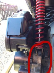

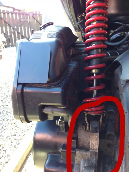

Hey, is there a way to clean this part of the metal? (surrounded in red)
its really dirty!! try to clean it as well as I can but its hard to get to, and cant believe its got to how it is to be honest.

Toothbrush and elbow grease!
Eddy89#3
Spray the area with a degreaser, WD40 works well. After cleaned and dry use an anti-corrosion spray to protect it, ACF-50 is really good.
ramo#4
If that's the actual engine case (?) then wire brush ftw

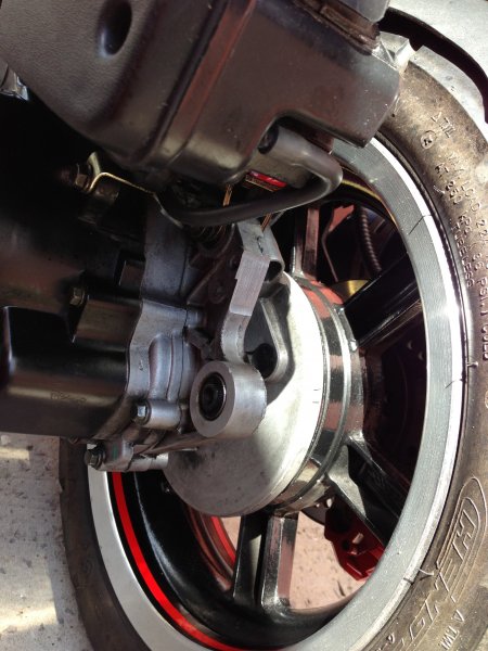

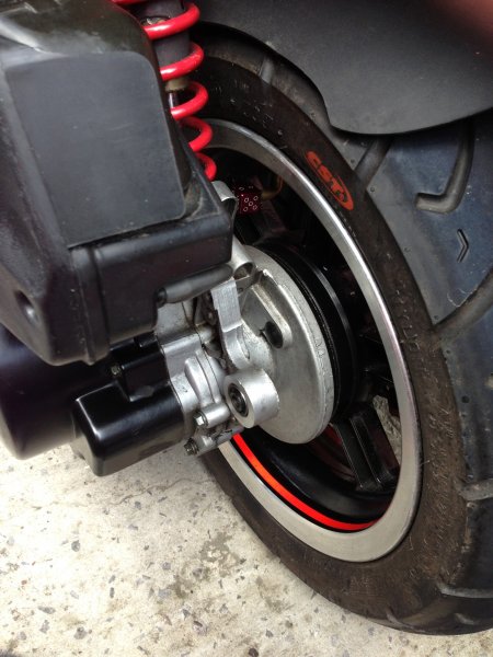

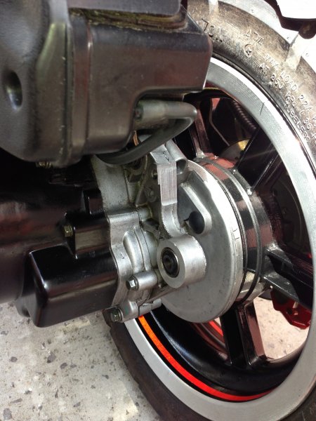

wire brush it till it is shiny as f**k, the use autosol chrome and metal polish and a clean duster to make it gleam :D
JoJo#7
Its getting there... some bits are really tricky to get in to!
