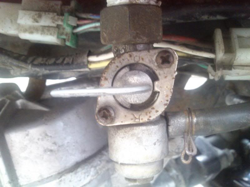

    okay, while im on and thinking. to kill the engine atm i have to stall the bloody thing. anyone any ideas on wiring to kill it? it will fire up fine without electrics so not sure i can find a way to get it running
    also fuel tap, ideas of positions for on/reserve/off. i thought i had it in the off position but bike carried on running fine

    put a switch in the live feed to the coil to use as a kill switch
    as for the tap, whip the pipe off and turn the tap (when the engines cold)...you'll soon know where off is :D

  20. Mark Emerson Trentham
    Correct me if i'm wrong,but why not undo the 2 screws an pull out an see how the tap
    works according to the position you turn it?.mk.
