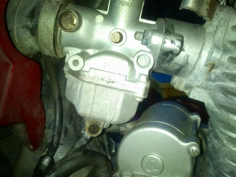

    so far ive been playing with these two
    on the side
    bottom
  8. hairyjim
    1,229
    Got a gilera ice

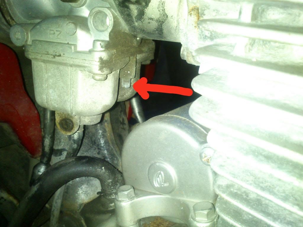

    right..the first pic is the throttle screw.the one that stops it dying if the cable is loosened off...if you can find any other screw then that will be the air screw.the bottom one is the carb drain screw..undo that and petrol should piss out.if they are the only screws you got...your screwed for mixture adjustments..it looks like there is a screw at/by the cylinder going upwards(second pic)??? if its a screw then i would say thats the mixture but it aint a clear pic to say if it is...is it a screw??

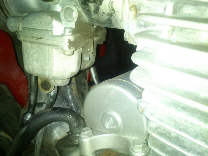

    this one, yeah
    i think (going off the smell) opening it up adds fuel, closing it up reduces it. but closing it right off doesnt seem to help.
    its manual choke. works fine apart form closing up over rough ground. lol
  11. hairyjim
    1,229
    Got a gilera ice
    yep that one there..i think thats yer mixture screw then...screw it right in then 2 1/2 turns out..adjust the top side screw till it revs steady and screw in the bottom one cos petrols gonna piss out other wise...thats a wierd place for a screw but it is chinkey..see how it goes on a run..if its rich still..screw it out a quarter and go for another run..bout ten mins should be ok...the first cold run go for a while..gotta get the engine to good operating temperature to have a fighting chance..if it still coughs after that and the mix is right then ide say clean yer carb..you might have to look at your air filter clogging your intake at high revs..if its foam..give it a wash in petrol and a light rinse in some clean oil...the oil dosnt need to be soaking...just a little bit to catch little particles and still let air through..dont run without one.it dont make it go better..just hides a problem by masking the issue

    right, the screw arrowed above, out 2 and half turns. other screw played with loads, it goes from just about where it can run smoothly, right to revving really high on idle. and my problem still persists.
