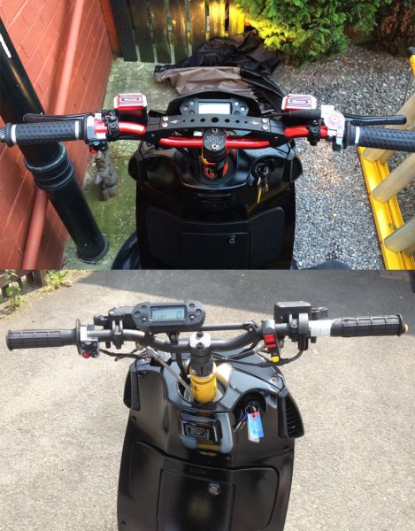

Yeah its really nice, i've replaced quite abit since having it, got the nicer styling parts on it and so on... it does run really well, picks up speed really fast! got to around 65mph on it but the roads aren't that long around here so haven't been able to do a long run... 45 up steep hills which I find good.. get to 50mph on normal street roads east, jets off from traffic lights and so on, just needs a little attention! 2 before and after photos, when the previous owner had it, and my most recent ones.
Certainly did a good job on tidying that up.bars are a 100times better looking.how the hell anyone could ride that how you got it i don't know.ive ridden a few wrecks but there was no need for it to look like that.

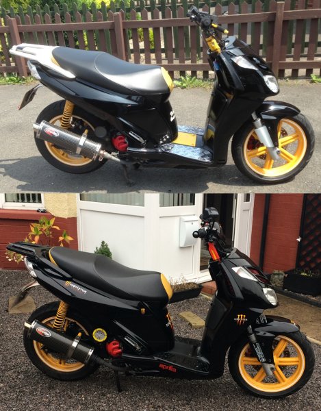

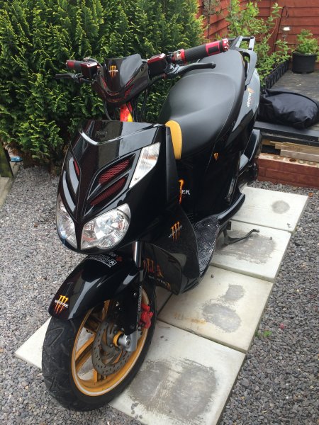

These are the 2 most recent pictures of it.... selling for £900 lowest, still Tax'd and MOT'd till the end of the year, and by the sounds of what people have said.. to sort it will be a pretty simple job, but I dont have the patience anymore with it, and the weather now is just rain and wind so will just wait for a sell.
