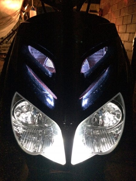

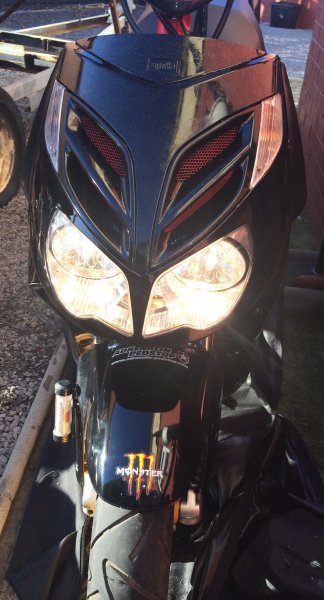

    I've just got Osram Nightbreakers, I wanted something WHITE, not Yellow or Bluey,
    and Halogen, not Xenon,
    Osram Nightbreakers I got now still got abit of Yellow to them,
    I have a White W5W Bulb in which is exactly what I want, proper White,
    but cant seem to find any Halogen WHITE ones for the main Bulbs.
    These are the Osram Nightbreaker ones, as you can see they're still abit yellowy:
    here is the cheap W5W Bulb I got, this is what I want for the main Bulbs, it looks proper White, no yellow or blue Tints to it (the middle bulb, not the one behind the fairing):
  4. scootzmadness
    clues in the name.
    theyre white.

    Well the Nightbreakers were supposed to be white but they aint.

    Kelvin rating isn't a measurement of brightness, is a colour rating. Brightness is measured in Lux.
    Warm white (the yellowy white) is rated around 2500-2800 kelvin
    Natural/Neutral white is around 4000-5000 Kelvin
    Pure white is around 5000-6000 Kelvin
    and cool white (the blue white) is around 6000+ Kelvin
    Ideally if you want white white you need around 5000K.
    As for brightness and dazzling effect of headlights, best checking legalities regarding MOT too dull/too bright may warrant a fail but colour rendering shouldn't, as long as it's not too blue.
