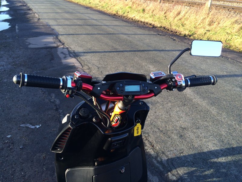

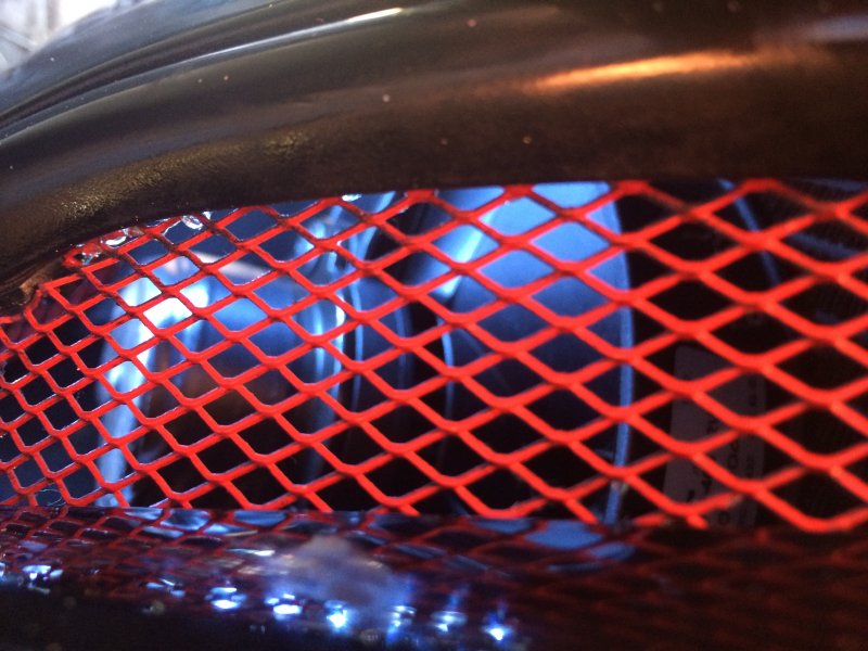

You can see the middle bulb in this photo but not much, its a small one, I think its just the bulb with abit of plastic behind it? (not like the proper bulbs) you can see in this photo its more of the yellowy colour than the other Bulb... and the new ones are the same 12v 55w as my original ones thats why I found it a little weird, changed them and there was a constant clicking noise from the battery, turned the Bike on and off a few times and its seemed to of gone now so might keep those in, just need hat middle one in white and not yellowy, then I can put my white LED strip down the middle behind that front plastic to light up the radiator etc... through the lanes again today, I cant wait for the Summer again! puddles and mud everywhere now :-( lol might put my Handlebar back like it was with the Speedo behind, dont like how they're angled now, weird! Just wondering, is there any way I can make the Handlebars lower, obv the Stem fits onto the frame, so if I chop down the frame and drill new holes for the Stem, the Bars will be lower...? seen some nice Bikes with straight Bars aswell, hmmmmmm....

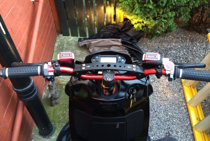

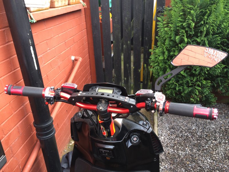

Hi hi .Jo Jo.I think you could lower your bars like you said..but the panel on the bars would have to have the clearance so it didn't rub or look daft against the front panel.if the bearing tube top is the same diameter all the way down then you shouldn't have any bearing mounting issues.my vision one is slimmer at the top than the rest so ide need to cut/weld lower down or fit bigger head bearings into the fat tube.but I don't see any probs doing it on that head..if you use A proper tube cutter and fit the bearing straight.if you feel up to free hand cutting and take it slow ...can't see why not...them middle bulbs need to come out and took to a shop and compared to what's available.can't tell bugger all from the picture. I like your thinking...nice to see a girl with imagination and the balls to do some mods...think I'm in lerv.go for it girl..

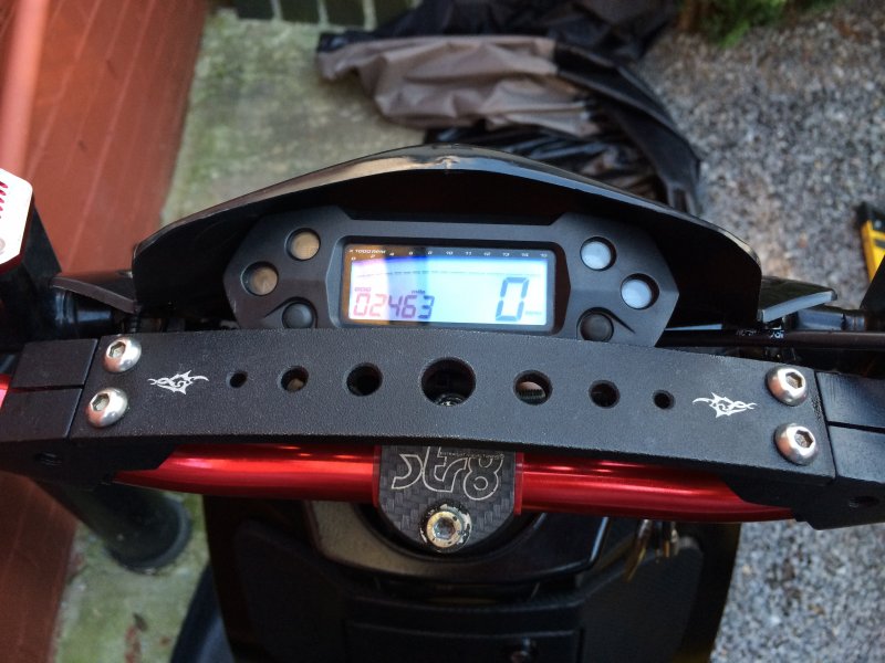

Put my Speedo back between the Bar and Doppler Cover aswell, hard getting it to stay with no brackets for it lol cable ties and part of a bicycle reflector bracket worked though! need new grips aswell, these have worn badly, hardly been used though! hate the Bike in this weather lol

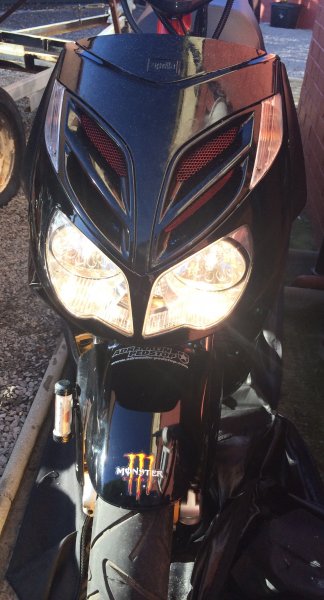

Got my new Grips and Mirror... put the new Osram Bulbs in aswell and theres no clicking sound which is good

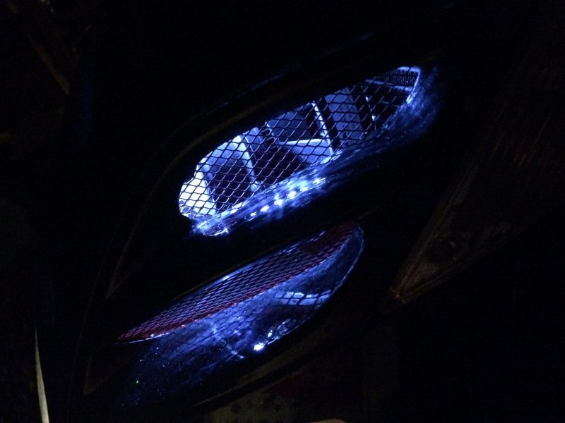

Sorted the Bulbs today, now the 2 main ones are either both on or both off the small middle Bulb is always on but isnt that bright anyway, only problem is the 2 I had free when getting the Osram Bulbs were yellowy, I found that Osram do a 'cool blue' so i'll get them, £8 something for 2, obv only need 1 but ah well, put the LED strip in aswell, thought it was bright white but looks blue, ah well, shines up the inside good even in the daylight, lights up the radiator... hopefully it doesnt look too stupid in the night... have 2 of the white nightbreakers on, then the middle yellow, and then a blue led strip :-/ but we'll see....

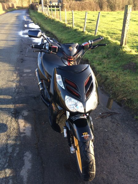

i liked the bike on the first pics, i think monster stickers look shit, i see them on every moped that comes in the workshop, just tacky if you ask me. i never had front l plates before i passed my test, some police are funny about it tho. about the bars, you could get some dropped ace bars, could look quite cool
Yeah im not too fused on the Monster ones, they were the only ones I could find with the Yellow on thats exactly like the Yellow on my Bike, im resprayed it all soon and most prob just have a couple Stage6 ones like this (my bike that I coloured on photoshop, not having the mudguard or front plastic red though).
So much for that LED Strip being White lol major f*cking blue more like! dont like it, got nothing else blue on the Bike apart from the Speedo Light!
Usually the white LED's come in 2 or 3 varieties of white: Cool White- blue looking, like you have Neutral White- White-est white Daylight white- Yellowy white like sunlight/streetlights. Used to work for a company selling LED lightbulbs and fittings. Apprently the best quality LED's are CREE and Epistar, cost a bit more, but when you compare the colour rendering to a cheapo chinese one there is a great deal of difference (as well as variation in the claimed wattage, and cost savings if using them for domestic/commercial use, not for automotive decoration) As a general rule of thumb a 7w LED bulb is equivalent to a 60w+ bulb. I've personally tested the neutral white in my house, very bright and look awesome!
Yep its annoying, I got a cheap chinese W5W Bulb and thats WHITE!!! I got the Nightbreaker Osram Bulbs which said bright white but looking at them next to the chinese one now they're more yellowy.. and the LED Strip which is 'white' its just on some next level blue lol so yeah, 3 different colour 'whites' on the Bike.

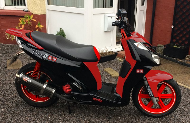

New colour way for the Bike, which im sticking to! also got my Stage6 Stickers today, still have to wait weeks for the weather to get better though :-(
paint scheme looks good,nice red that.on the subject of bar mounts...find a man (or woman) with lathe and have one made to your size.if i still had mine it would take about an hour cos it was a little manual one.. big old jobby can turn it and have it in your hand in 20 mins tops.nice piece of aluminium and paint or anodise later.
