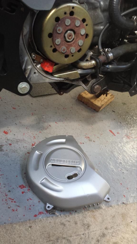

    Done a small amount of work this weekend on the FXR. Replaced the temp sender unit as I have not seen the gauge move since I hade it started. Also the spark plug has been replaced as a precautionary measure. The scooter has only really been ridden on a couple off occasions but the scoot doesn't seem to pick up very well at all. Seems to be firing erratically and the plug is wet and oily.
    On that note I decided to take off the generator cover just for a quick gander. Decided to plastic prime and give a coat of silver paint. This got me thinking...what is the hole in the side casing for? The one that is plugged with the rubber bung? I thought these scooters had fixed timing with the pick up and stator plate locked. If this is not the case is there a chance that mine is out?

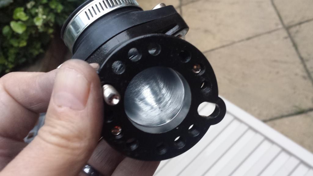

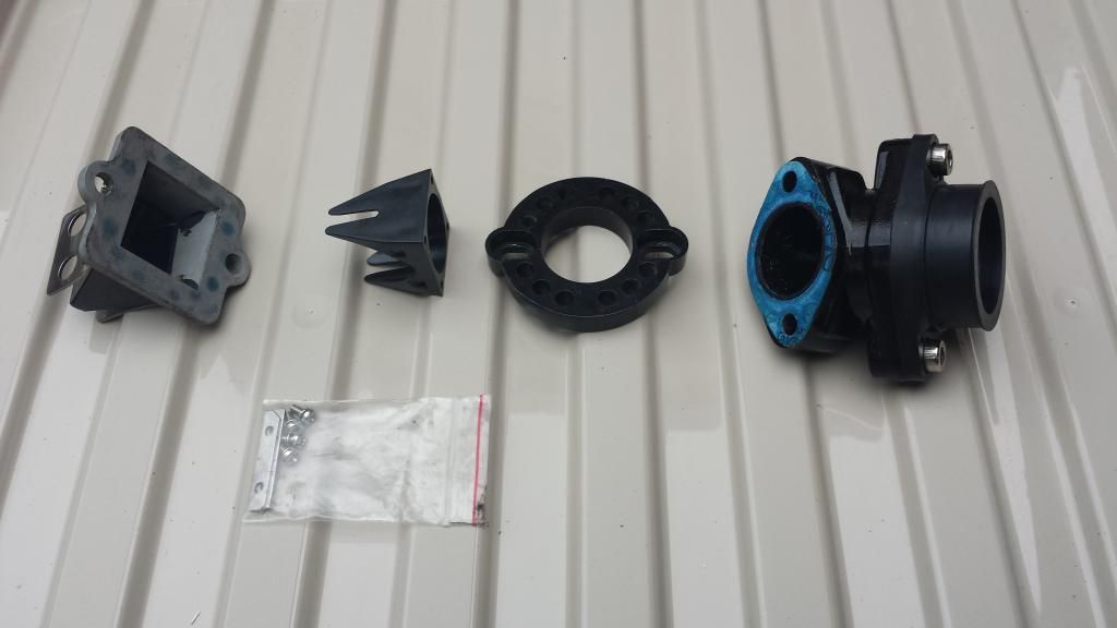

    Since i have taken my carb off to frig around with the jetting I thought I would strip off the convoluted reed valve assembly and inlet manifold. I bought this lot from Midland Scooter Center about 2 years ago. I needed somthing to mount the OKI 24mm carb onto and this was suggested by the guys in the shop at the time.
    The first item on the Left is the reed valve (obviously). Now I fitted a set of reed stops that came with the kit. If you can see in the bag there are a couple of thin plates and a few screws. These were all that were holding the reeds in place before i dropped the stops in. If anybody can offer some advice in this area should i remove the reed stops and revert back to the original set up from a performance point of view. I haven't set the scooter up properly yet and only rode it a small distance to the MOT test center so i am pretty much re visiting this area due to messing around with the carb.
    The item second from left is a small black plastic item that you pop in the mouth of the reed valve. No i can only assume that this is to smooth the air flow into the reed block. The only problem is it seems to cause more problems than it resolves. Reason being that it actually protrudes into the opening of the inlet manifold by a 1 - 1.5mm (the first part of the manifold being the round item next to it in the photo). Should i ditch that part and suffer a bit of turbulence in the reed block area, or would the restricted aperture be the better of the two evils?

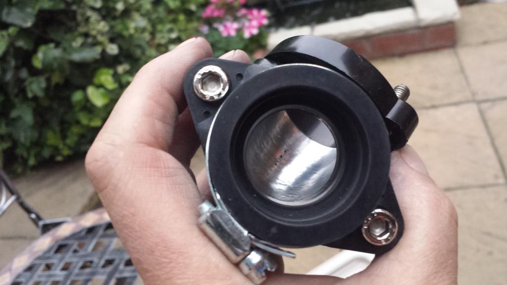

    The round part I have just eluded to in the previous paragraph is the first part of the inlet manifold. It consists of a ring that bolts into the crank casings which in turn locks the reed block in place. It has a series of threaded holes which allow you to adjust the angle of the second part of the manifold (far right in the photo). I noticed when I matched the parts up that the gasket was too small as was the size of the inlet aperture on the main inlet. I couldn't live with this so decided to get the dremel out and modify to suite ;)
