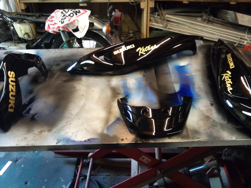

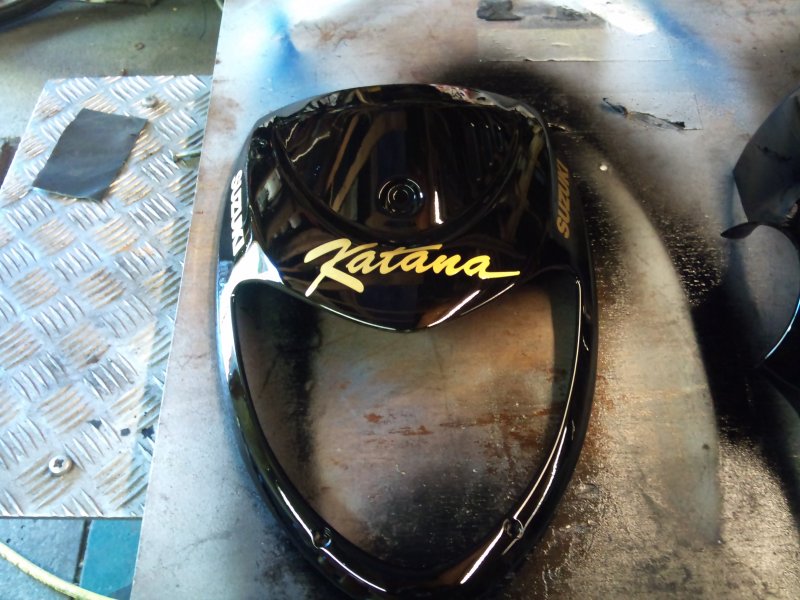

  5. Stevep
    Decaled and laquered, the first coat anyway:
  6. Stevep
    All main panels finished and decals on, just sprayed the inner panels with satin black to smarten them up a bit, will do the wheels and fork ends and caliper a little later, got one in for MOT shortly.

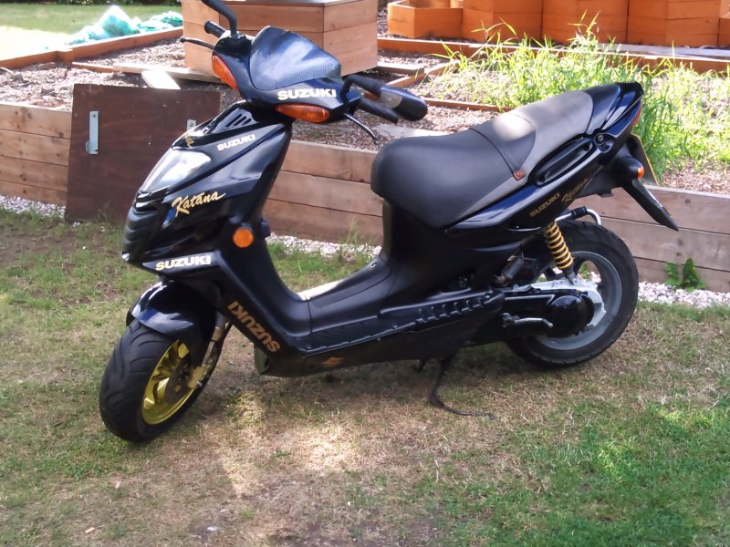

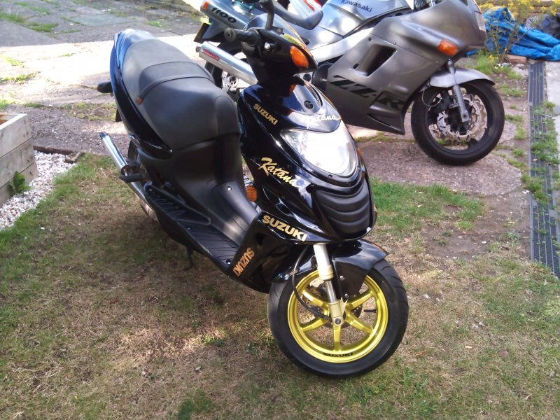

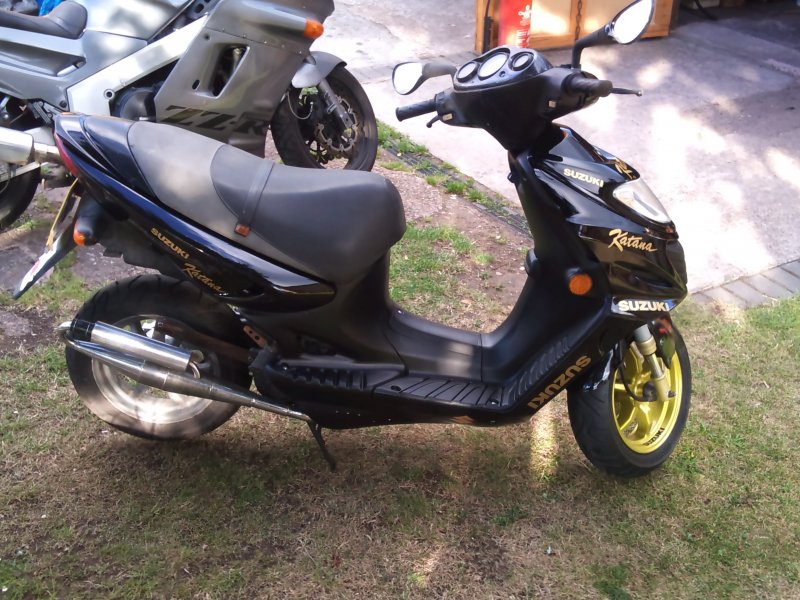

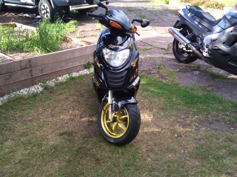

  9. Stevep
    Here we go then, just the rear wheel and shock to do now.

  10. Merlin
    Merlin Old School Biker
    2,305
    2007 TKR WRC 50
    Only with keys, brake fluid or paint stripper, to people that piss him off. :D
  11. Merlin
    2,305
    2007 TKR WRC 50
    Er, Katana doesn't have 'Kerry' in front of it? Just kidding. :p
    The 'Suzuki' decals are upside down on the lower front fairing panels.
  12. Stevep
    Got it in one!

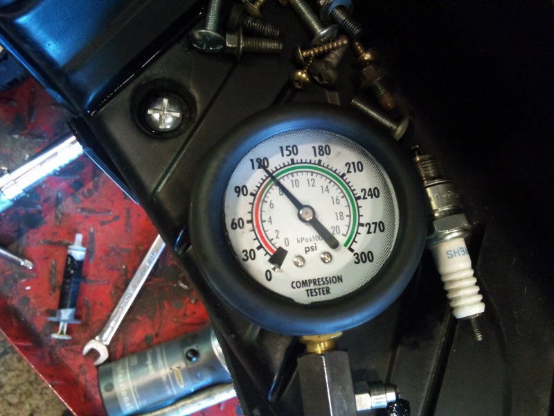

  16. Stevep
    Barrel back on, new gaskets, torqued down.
    Compression test.
    That'll do nicely I think:)
