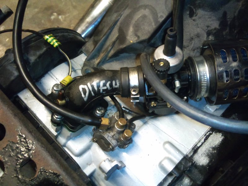

    I had a feeling, always go with your gut instinct, I bought the manifold and it fits nicely, perfectly actually.
    So if anyone else is doing a Katana and you have the standard metal manifold and you want to change it so you can fit a multitude of rubber mounting carbs, get the manifold off an SR50 Ditech.

    Also got myself thinking about the oil supply. The oil pump supplies feed to both the crank bearings and then onto the piston, but with the manifold conversion, using the ditech manifold, it has an oil pipe feed in it right on top of where the reed block is, you can see it in the photo earlier above. I'm toying with the idea of splitting the oil feed pipe and putting a feed to the manifold pipe as well. A little oil feed closer to the piston cant be a bad thing in my opinion, especially with an upgraded cylinder.

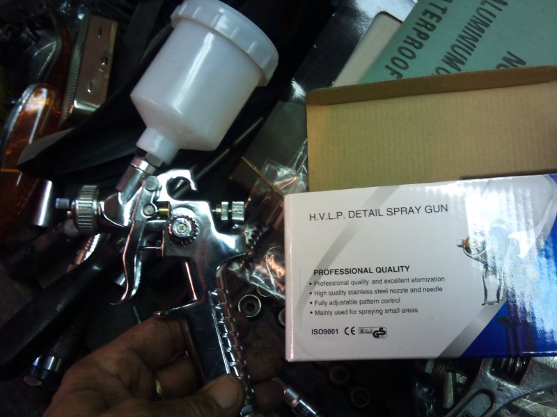

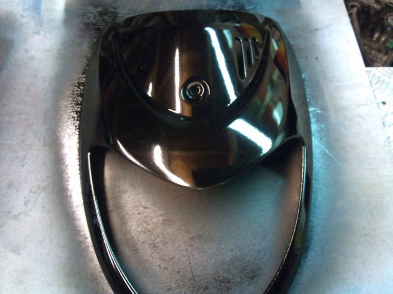

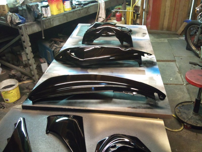

    It getting there.............whipped the panels off tonight and rubbed them down with 400 grit wet n dry, gave them a flash over with my new toy.
    125ml detail spray gun. Tidy little piece of kit.
