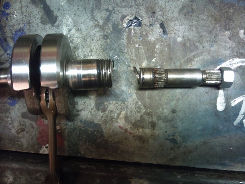

    So, last Friday, after fixing every other scooter in the neighbourhood, i finally get round to stripping the Katana engine down (again) and replacing the crank for the new one i bought on November 22nd.
    Put it in, tightened up the cases, starter motor in, carb on, filter on, stator and flywheel, build it up on the bench and then into the bike complete.
    Come to fit the starter ring and variator, can't! Something wrong here, why is it touching the casing inside???
    And the starter bendix wont even think about catching that edge there.................
    So left it alone for the day, its getting late anyway.
    Went out next morning, thought sod it, lets have it out again and see whats going on.
    Out it comes, placed it next to the old crank and spotted that the new crank is missing a spacer collar on the variator side. Without that, you can't fit anything that side. Just wont work.

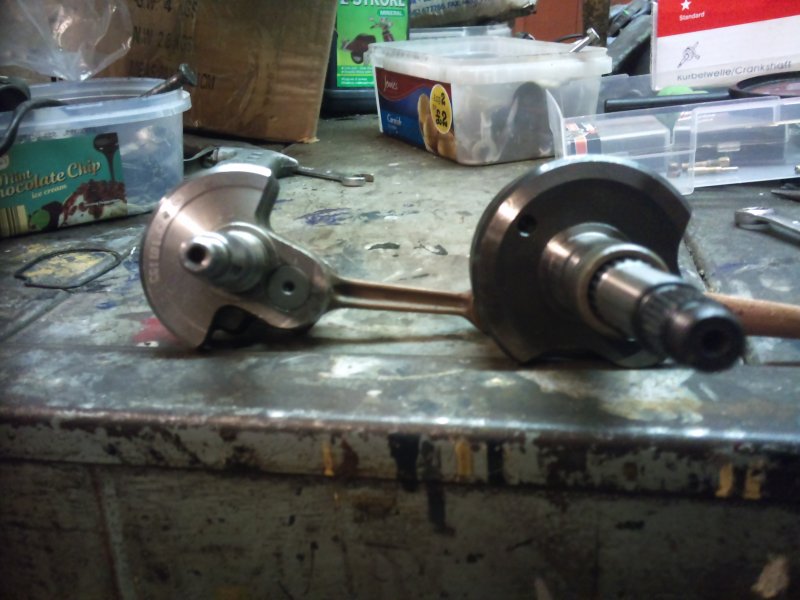

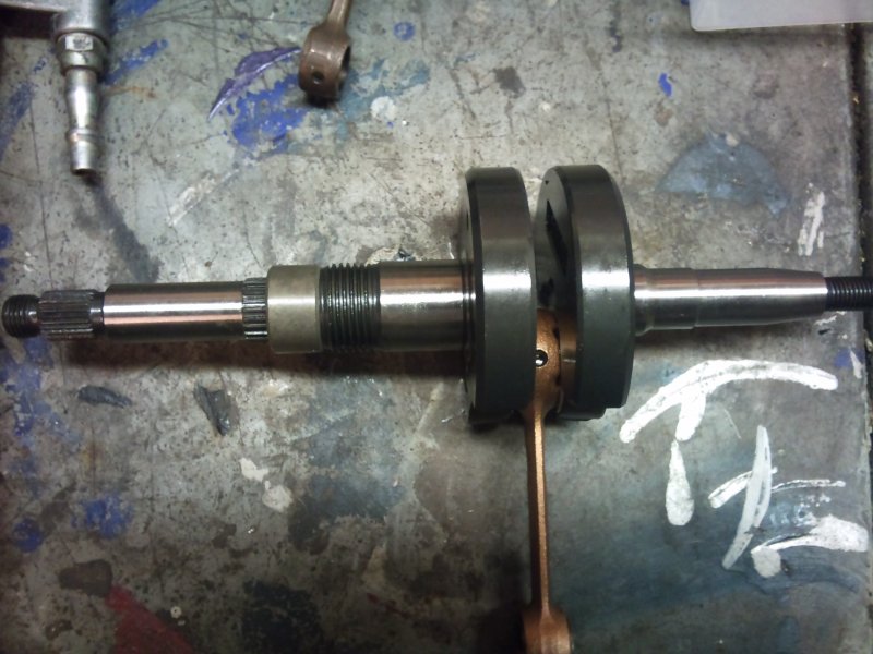

    New replacement crank arrived, yay, it's got the collar on;
    Cant fit it though........the friggin webs are too big for the case!:mad:
    So.........drastic measures are now called for.
    Will post photos later.
    :mad::mad::mad::mad::mad:
  17. scootzmadness
    please do not tell me your sticking some sticks of dynamite in the cases ;)
  18. Stevep
    Close............but no cigar.
    Briefly thought about having the cases machined.............na, not worth it.
    Here's a couple of photos of the collar in place and the oversized webs
    Right then, only one thing for it..................where's that angle grinder??????:confused:
    AHA!:D
    That got the bugger:eek:
    Once the collar was off the old crank, slipped very nicely onto the new one, sorry not got a photo of it, got carried away with doing the job.
