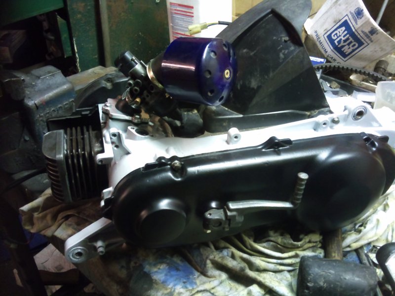

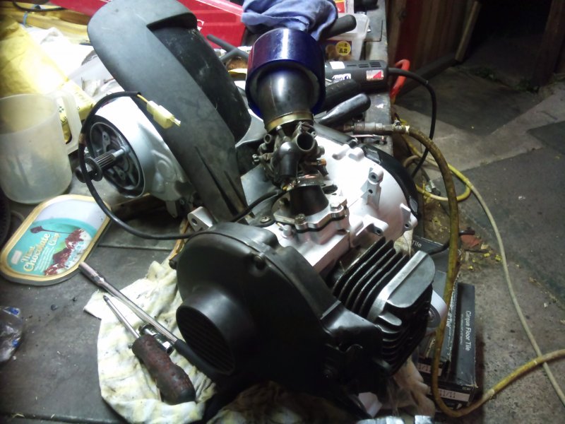

    Right, so, engine split again, hoping against hope that it isn't going to be the 6205 bearing that's shot, simply because i haven't got any of that size in the box. Plenty of 6204's but no more 6205's.
    Took a chance and changed the 6204, put the halves back together and tightened everything up...................YEEEEEESSSSSSSS:):):) nice and smooth.
    Just to be sure, put the flywheel housing on and gave it a spin by hand; lovely.
    Built it all back up (again) and it is now back to how it should be, will be into the bike tomorrow night.
