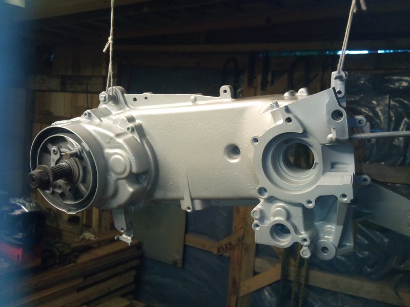

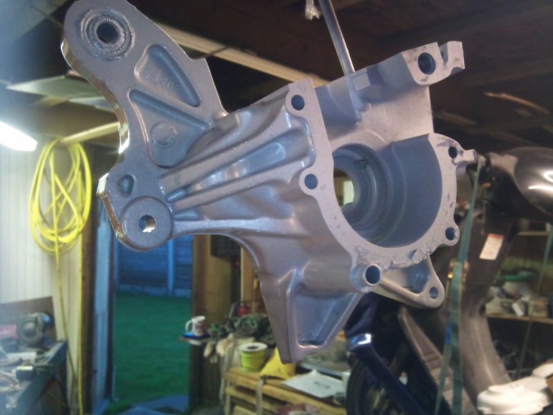

    Been a hell of a week, stupidly busy, but have managed at last to get the cases painted. Yay, it's moving on a bit.
    Just need to laquer them.

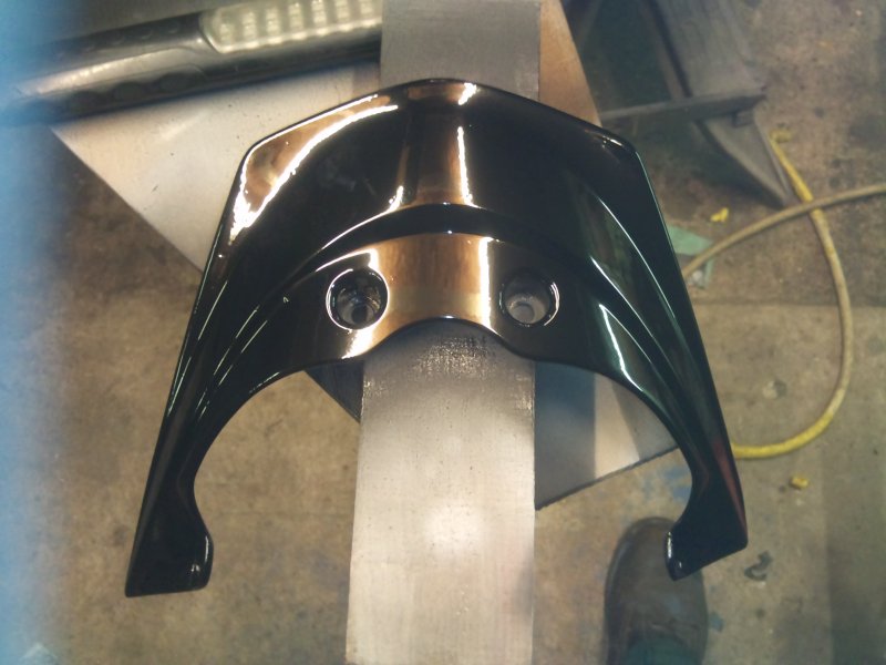

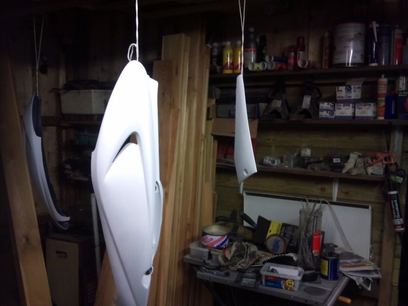

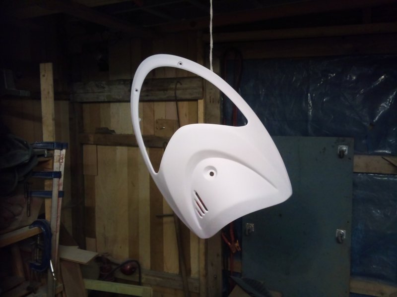

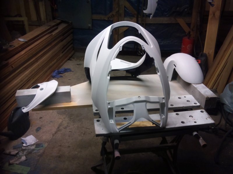

  13. Stevep

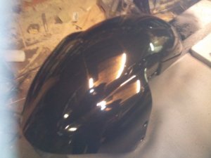

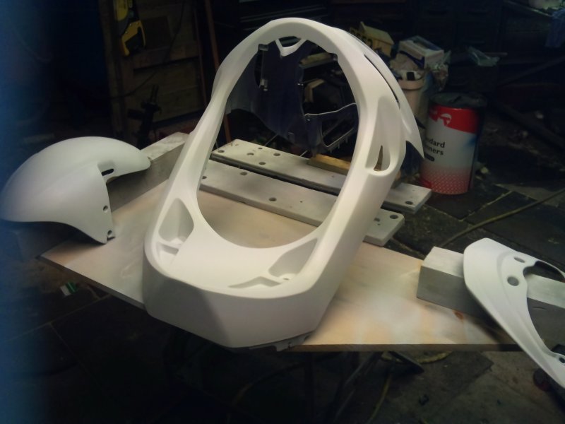

    Well, I got the crank back from the shop, had a quick chat with them and it turns out that he doesn't like doing these cranks because it takes too long to balance them, plus, as standard they have no thrust washers each side of the conrod, which he also doesn't like. I'm sure if Suzuki thought that they needed thrust washers then they would have put some there wouldn't they?? Apart from that, it's fine. So at least I can start to build the engine back up again.
    So I spent all day saturday, and i mean a good 10 hours, rubbing down the panels. Halfrauds bloody laquer:mad:
    By the time I finished I had rubbed through the skin on two of my fingers! And one of those is the important one!!!!!

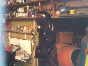

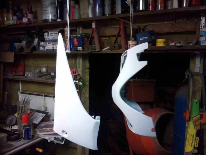

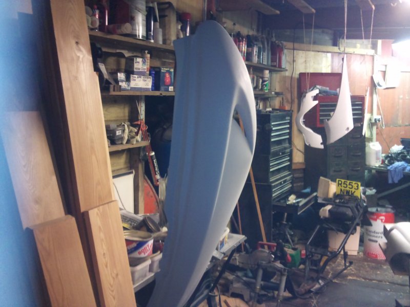

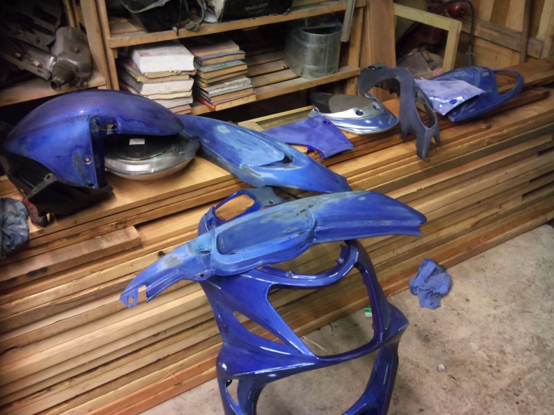

    Then all day sunday plastic welding, sanding down the welds, priming, sanding, topping up, sanding, priming........til it got here:
    DSC_0067.jpg DSC_0068.jpg DSC_0069.jpg DSC_0070.jpg DSC_0071.jpg DSC_0072.jpg
    Then some more prep work to the primer.........400 grit, primer, 800 grit, more primer............and all this whilst the bloke is here cleaning the carpets and rugs in the living room. Had to move the bloody lot of furniture out for him as well. And he wanted paying for it! Bloody cheek, should be grateful I gave him a job to do:rolleyes:
    Not really, he done a great job considering I'm always in and out with my boots on.
    I digress;

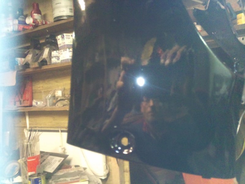

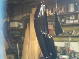

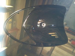

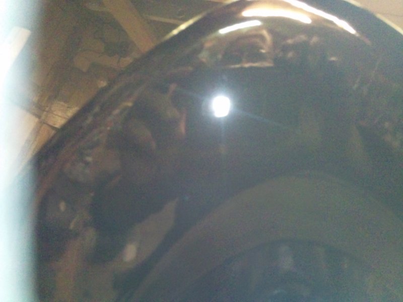

    Scramble over the crap to the racks, grab the paint, et voila!
    I just noticed that if you look close at one of the photos, you can see my ugly mug in the reflectiono_O
    DSC_0073.jpg DSC_0074.jpg DSC_0075.jpg DSC_0076.jpg DSC_0077.jpg DSC_0078.jpg DSC_0079.jpg DSC_0080.jpg
    Not laquered anything yet but looking good so far.

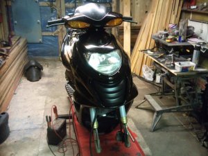

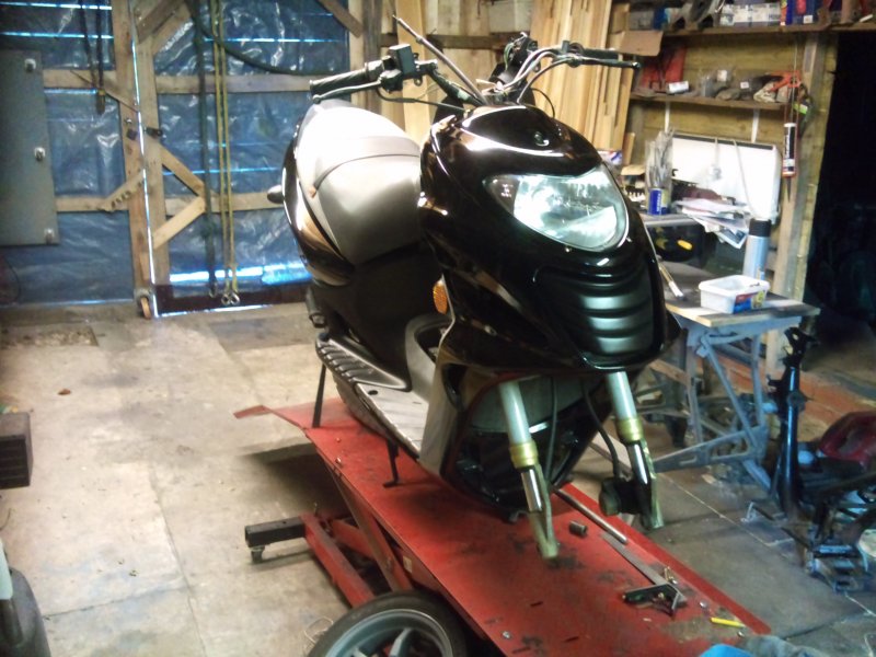

    Yikes, what a day, managed to do absolutely nothing all week on the scoot, but got the whole day in today.:)
    Starting to look like a bike again now.
    Had to sort out some of the electrics, front brake light switch wiring had been crushed and split so cut it back, extended the wires and new terminals, replaced the rear brake light switch which for some reason wouldn't sit right in the lever clamp, new terminals on that as well. Yay, brake lights:D
    One of the rear indicators needed fitting properly, flopping about like a fish, done that, soddin' 5mm fitting, then found the wiring from the indicator to the loom was about 2 inches too short!:mad: Genuine suzuki as well.
    Indicator off, stripped, re-wire, new terminals, re-fitted, aaahh thats better. Yay, indicators now as well.
    Checked that the oil pump light is working, good job i did 'cos the bulb holder was shot with corrosion, new holder, shorted the connection and nice red light on the dash. Lovely. Will check the sender unit tomorrow so i know that is good as well.
    Then shorted the fuel connection to check that, all the way up and down again. Nice.
    Bit of untidy wiring and dodgy/tired looking bullet connections on the rear end so replaced all of that as well.
    Now at least I know I will have good connections with very very little chance of failing and me having to spend hours looking for an electrical fault in the wiring.
    Thought i had better fit the panels because they stand a better chance of not getting scratched if they are on the bike rather than sitting on the shelf where i am always reaching for things.
    Decided that I'm not going to do the gold flashes on the body, gonna keep it all black; wheels will still be gold, as will the fork bottoms and collars and brake caliper, but have ordered new decals in metallic gold which should set it off nicely.

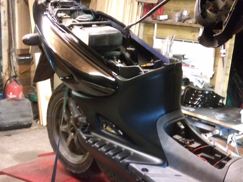

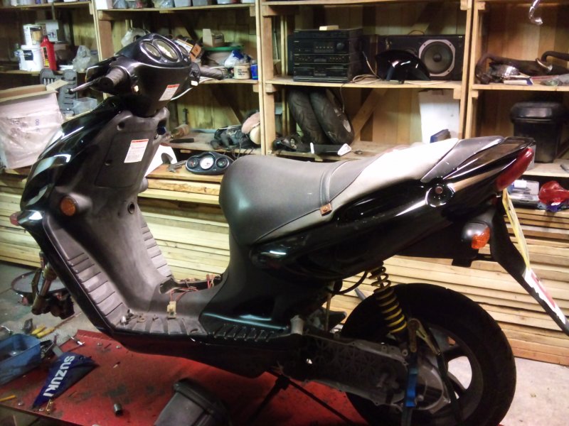

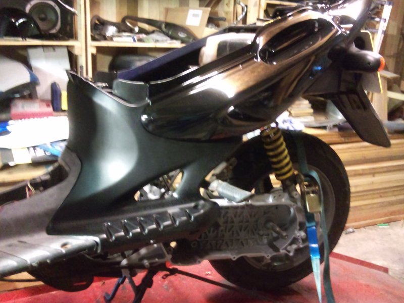

    Still have to spray the foot board and knee panel satin black, but as you can see from the photos, the under-seat panels have turned out nicely, makes it look like new again. DSC_0118.jpg DSC_0119.jpg DSC_0121.jpg DSC_0125.jpg DSC_0126.jpg
    More to do tomorrow. Maybe clear the bench off and do the engine, we'll see.

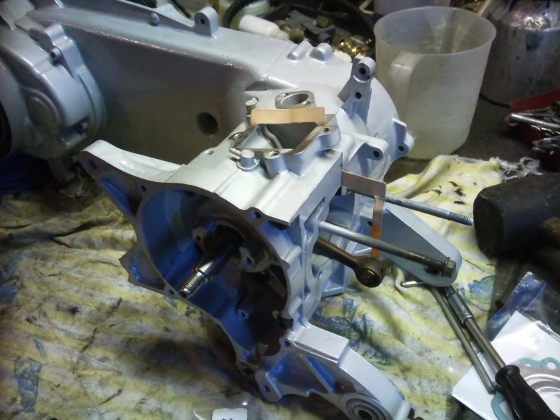

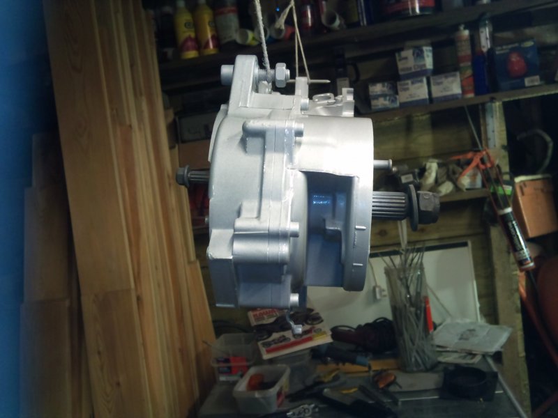

    Well...................got the new crank bearings and seals in, new crank half gasket, looks like this:
    Now i got a little mindbender.
    It's notchy:confused:
    When you turn the crank by hand, it's not smooth. It's like the second hand of a clock, no noise or anything like that, but it's as if you are turning a dial and it's dropping into position, like off a cam and onto a flat, but there are no flats.
    I think I got a duff bearing. New one as well. Ah well...............split it again tomorrow i suppose and have a looksee.:(
