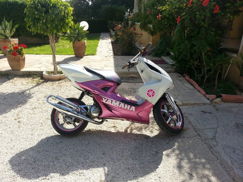

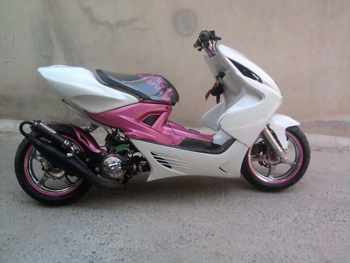

photo's?
need a pic of the parts or of my bike?
of your bike, you dont see a lot of hebo racings now days, you should post up some photos

old pic
new pic
all filters are restrictive to a point, the trick is to put on a filter big enough that any decrease in flow wont be noticed by the engine.. if you stick a filter on a bike jetted for no filter it will run rich (unless its a fucking massive filter) still... running zero filter is just silly.. run a flat backed filter.. get EVEN MORE noise than without a filter (also helps with the inlet pulse reflection... will gain power with a flat back free flow filter)
