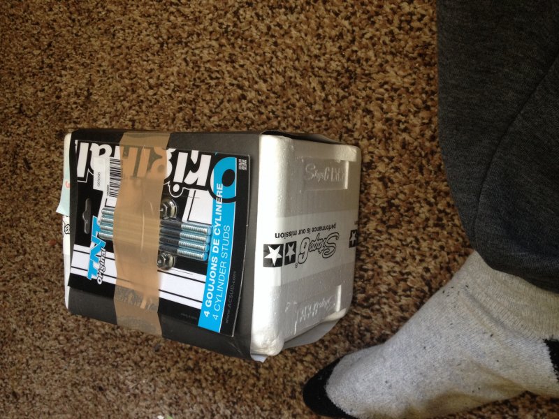

    Also il be fitting this to my other aerox when I'm off work on Friday :)
  9. turbovetto
    turbovetto Well-Known Member
    1,561
    tweaked ovetto
    Should be good !
