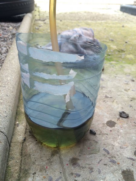

    Photo from bleeding the rear break today, that isnt a small bottle either, its wide!
    yet theres still no resistance in the lever!
    its weird as again.. when the pads are out and you pump the lever the pistons come out easy,
    its just that once the pistons have pushed the pads to the disc, thats it...

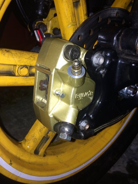

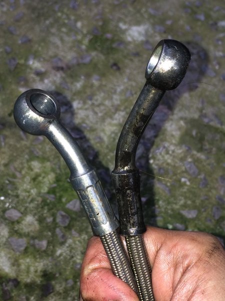

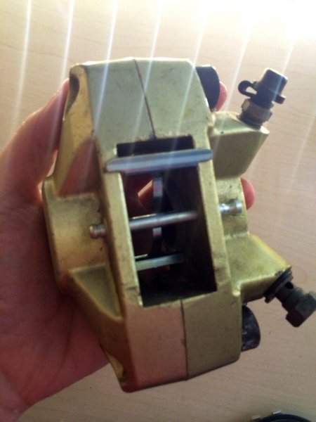

    Got the new Caliper for the Bike, fitted... Pistons are coming out fine... bled it, but still nothing...
    Took the Hose out from the Bike and fitted it outside, bled it, plus used the Vacuum, no leaks in it, no bulging etc, but still nothing..... I have the original Master Cylinder on which is 100% working, only reason I removed it was because it was too big, so I know theres no problem with that, Calipers from an 100% working Bike as I seen it working myself on the Bike it came from... only thing left is the Hose but again I cant see anything wrong with it... i'll get a new one anyway just incase.

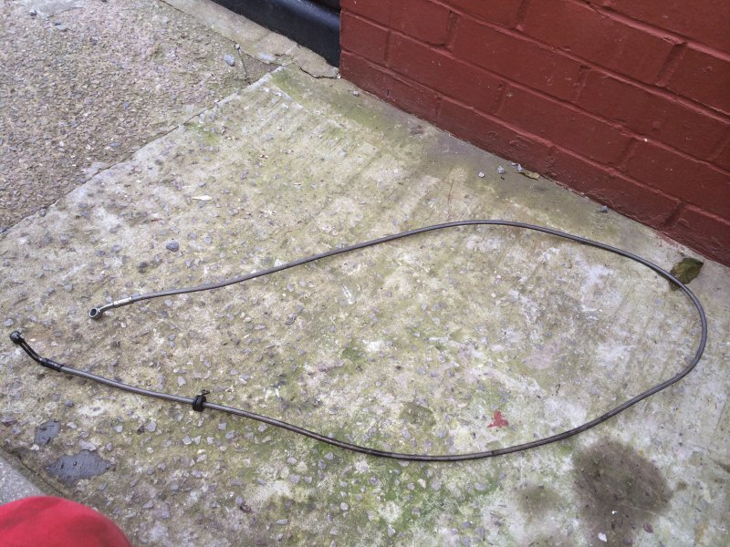

    Honda MSX
    Here's the Hose on the Bike... no bend or anything
