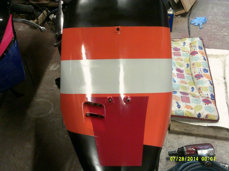

mines black..its a mix of flat and gloss..using Matt as base for the gloss...it was red to start with but does look better black.them rollers should give you a good starting point..maybe even be good right out of the box...never can tell..if your only after a better bit of take off and not going manic..ide say if you can pull up the biggest hill you can find with out feeling its pulling wrong,ide leave it at that.your lump ain't gonna be in its first flush of youth so power ain't gonna be blistering...you could set it for a fat arse and a light arse will find it a totally different machine...the rollers are only half the story though...you could play with the clutch springs to get it biting differently and the contra spring to adjust the cluth pully ratio relative to your variator pulley...one thing at a time and if it don't work...you know what you did to make it do it..if you throw too many mods at it with out checking the results ,you wont know where you naused up.I'm about 15 1/2 stone so if it works at your weight..might be good reference for me..
now funnily enough im 15.5 -16 meself,will let u know !! lol got a bit more work on plastics yet tho, but getting there ish, sunny hot weather we want for painting

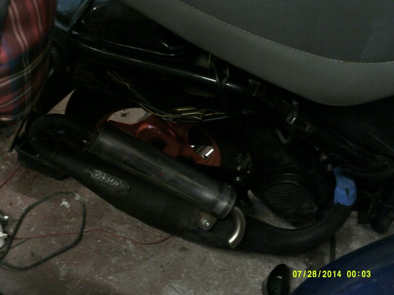

I had to adapt the mounting bracket with rubber spacers/bushes to take some of the vibes out of exhaust ,as I had to reweld the flange back on twice, bracket is now a little bit ugly but seems to be ok , boy is still giving it death tho , lol some American sites really good reading if u have the time, Honda vision is called the spree over the pond
