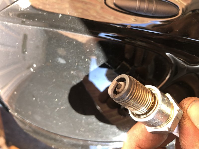

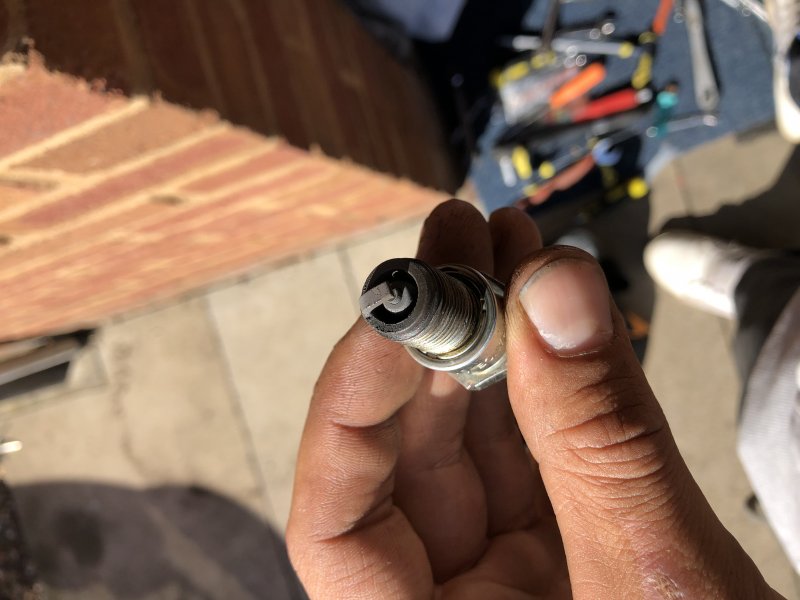

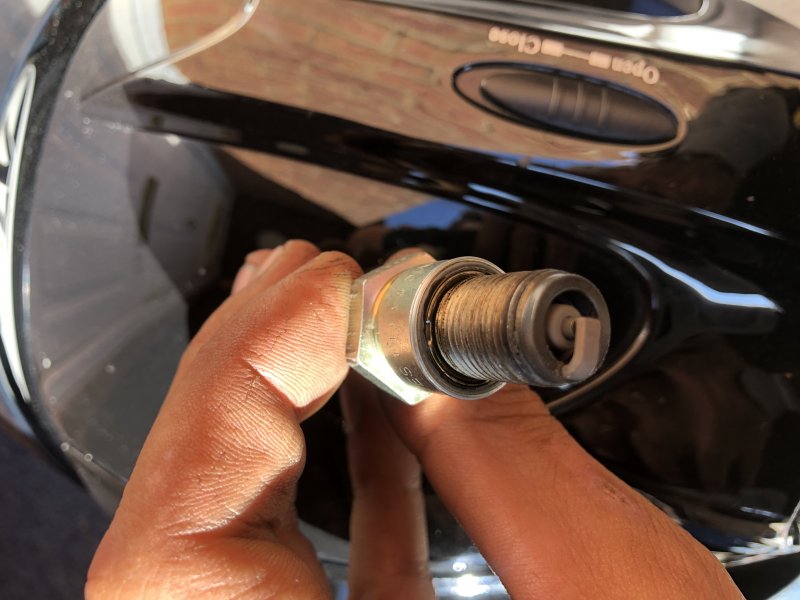

Looks good mate I wanted to your whole bike well I just top up fluids from cold I done bleed screw on streetrace cylinder made sure cooliant was comming out started her up made sure no air bubbles top up fluedputcap on rad is nice and hot top and bottom just took it for a 5 min ride nowwsiti g her to cool down and rebleed one more time cup of coffee time Well yesterday I spent hours and hours on end trying to bleed the system thank God today I found the problem well it must be the problem because now the radiators getting hot my temperature sensor is broken doesn’t help but as Ped Parts said as long as the rad hot top and bottom you should be good to go fully bleed .... yesterday though I did put the butterfly clip up to the second notch fro. top because I moved it to the middle to solve take off sluggish in middle I’m at 2 turns out I may pull the spark plug out in a moment just to check the colour of it and I’ll repost some pictures up here
Well just got to work the radiators nice and hot still obviously I can’t tell the temperature but I’m pretty sure it’s okay still getting a lot of splattering on takeoff in fact with the butterfly clip from the second note from the top seems worse the mixture screw set at two I’m not too sure if I should go down to 1 1/2 for 1 1/2 onwards there is no difference in idle speed but I’m running to get to so maybe I should go back to 1 1/2 what do you guys think

You know that u dont touch the transmission unntil u perfect the carb at least on full throttle right ? U cant be doing that take off doesnt matter u must get the mixture perfect on full throttle so u dont risk to seize the kit after that u go to the cvt and then if the carb needs a bit adjustments u just touch the needle to perfect take off and crusing at 1/8, 1/4 , 1/2 throttle.
Hi mate thank you for the reply yes I agree but what I’m saying is a down jetted today from 85 to 79 and spluttering still there are you telling me I need to Down jet even more it’s a stage six street race and stage pro pipe 17.5 carburettor I really could do with some help
I put 4.0g btw and now on full throttle I get splutter before it was mix with 4.5 and 4.0 something not right
I dont think u are runing to rich so its electricity problem, first thing first try new spark plug, then other stuff cdi and the other stuff.... somethings not right. If its too rich like this it would shut down u have electricity problem 100%. Also heat range for your kit is NGK BR9ES if i remember right maybe ngk 8 but i thinks its 9.

Try 92 jet then see what it happens, as i said again u have electricity problem doesnt mean that its new its functioning , maybe they gave u wrong cdi.
Hi mate And thank you for your reply it means a lot to me well I’ve just been to Halfords and purchased some straps I’m going to do the Earth strap modification that I’ve read on this forums about the earth straps are not good I wanna try that first and then go from there then I will try a bigger jet and see what that does the CD I that I purchased was unrestricted version the coil is the correct version as well
