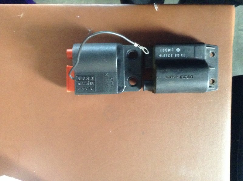

Thanks got that right now I have bought a Athena cdi but it has a black wire sticking out (see pictures) not like the one I took off please could you tell me how I connect the black wire please Thanks Andrew
