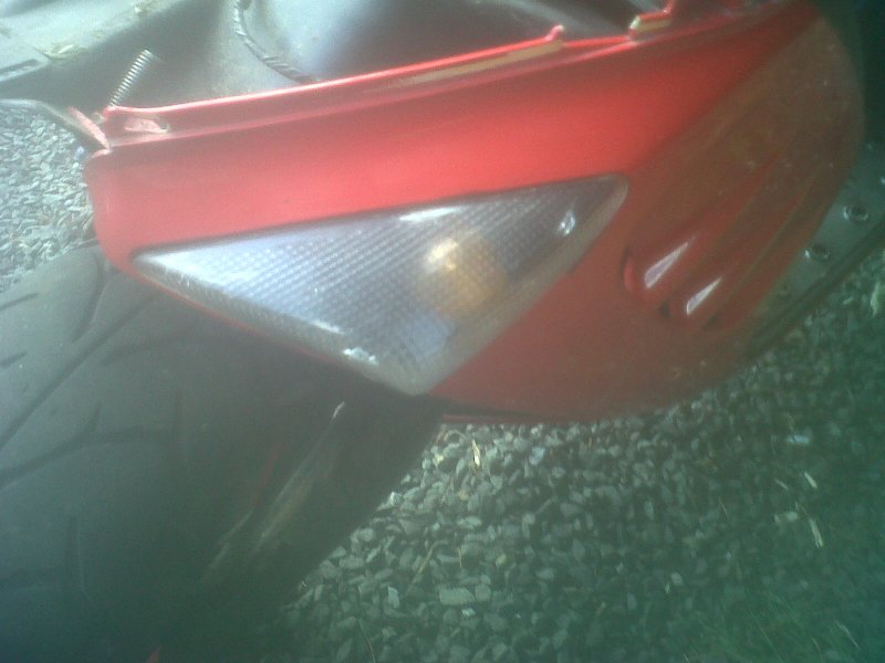

    Got some pics as requested of the smoked indicators, not the best pics becasue BlackBerry cameras are shite,
    I quite like them because they're something different, and just clear lenses look a bit chavvy IMO
    They are so easy to do, just remove the one screw holding the lense on, mask off the bulb & around the silver indicator surround, and spray, satin black worked well for me :)
    Also did the headlights which look really good too IMO

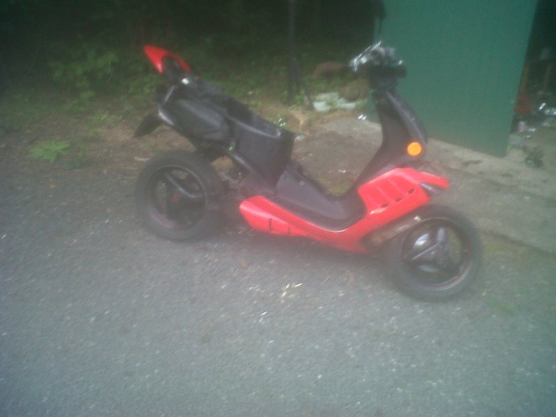

    Finally, the pug looking a bit sorry for itself waiting for its rebuild to get finished

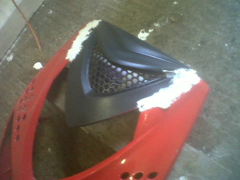

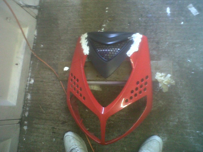

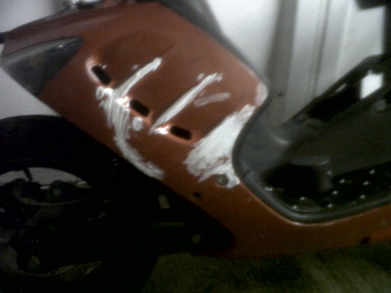

    Not much progress with this, my full gasket sets been delivered and waiting on a spark plug getting delivered
    Have done a bit of work on the front panel as one of the previous owners either cut or snapped off the bit where the upper grille should mount to, so I saw it as an oppourtunity to smooth the upper grille into the front:
    Just waiting on the filler to set then will get it sanded off and sprayer, going with a red and black colour scheme, which should look really good when its finished :)

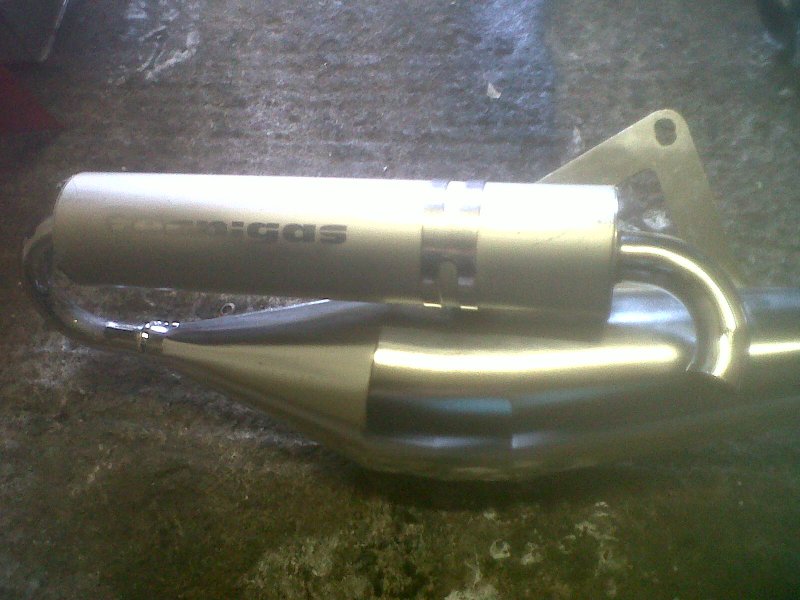

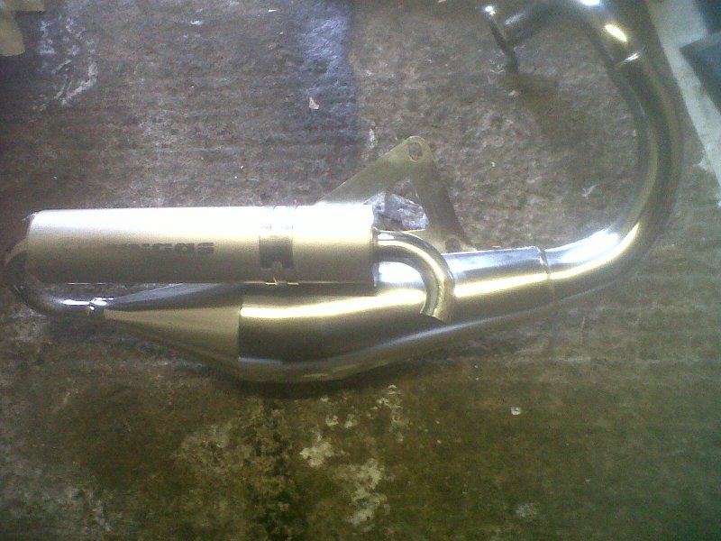

    And while I was in the garage I thought I might aswel give the exhaust a bit of a clean up and shine :D
    Cleaned all the much and bunt on crap off it using Mr Muscle oven cleaner, left on for 20 mins and lifted all of it off, gave it a wash then just used a little bit of Brasso to give it a shine and has come up really well :)

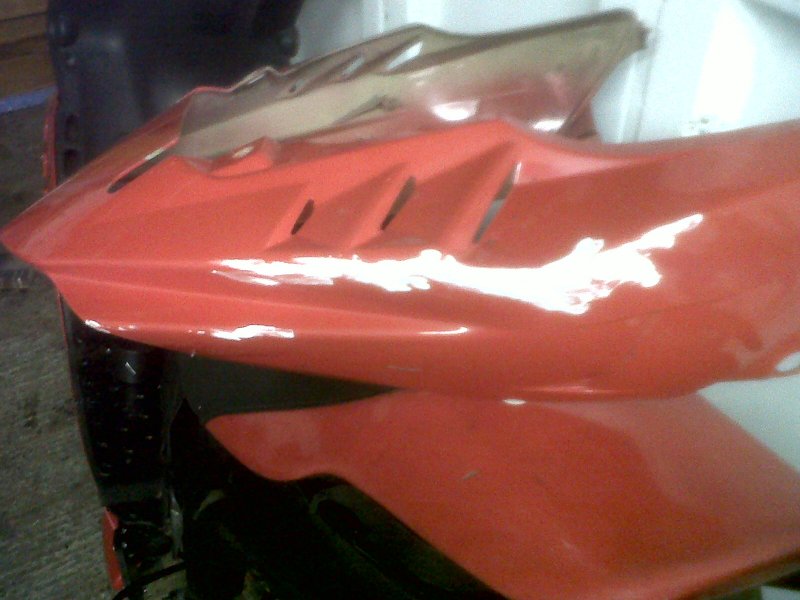

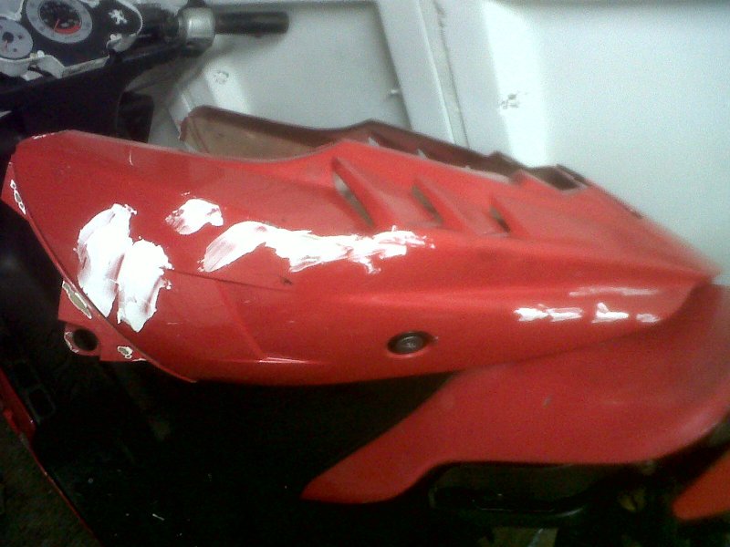

    Little bit more progress on the beast, been filling panels to be smoothed off then painted:
    IMG00044-20120823-2211.jpg IMG00045-20120823-2212.jpg IMG00047-20120823-2305.jpg

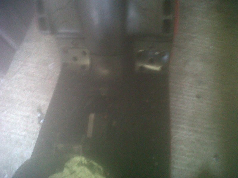

    And need suggestions now, now that I have taken the snake lock off, theres a hold in the rear panel that used to be filled by it and the surround, which isn't lost its misplaced, so does anyone know what I could do to over come it? I was thinking of some fine black mesh with a red LED strip behind it.
    Heres a pic for anyone that doesn't know what panel I mean haha
