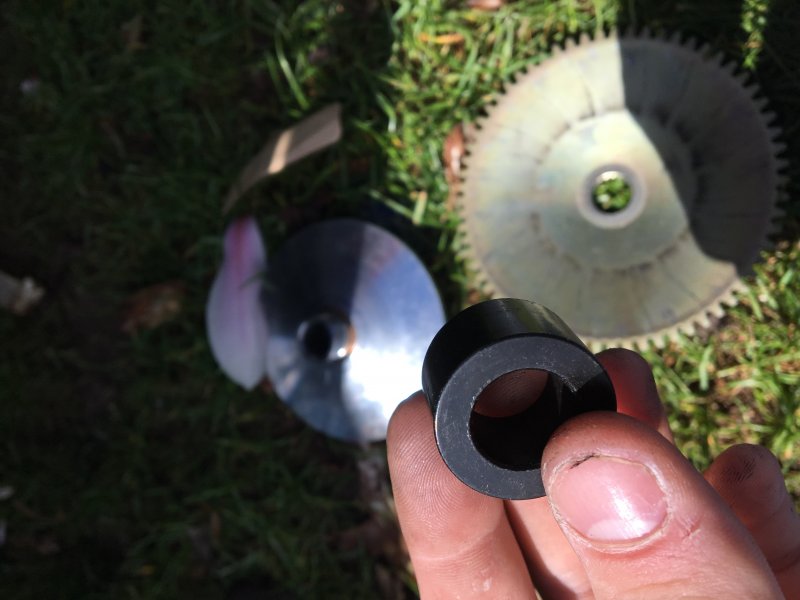

Woah, thanks for the quick replies guys. The variator came with the rollers and I'm certain the belt is correct, I'll take the cover off and let you know what's happening in there. Also want to make sure I've installed the variator correctly, it came with come black spacer? Kinda large and about an inch thick? Any idea? Thanks

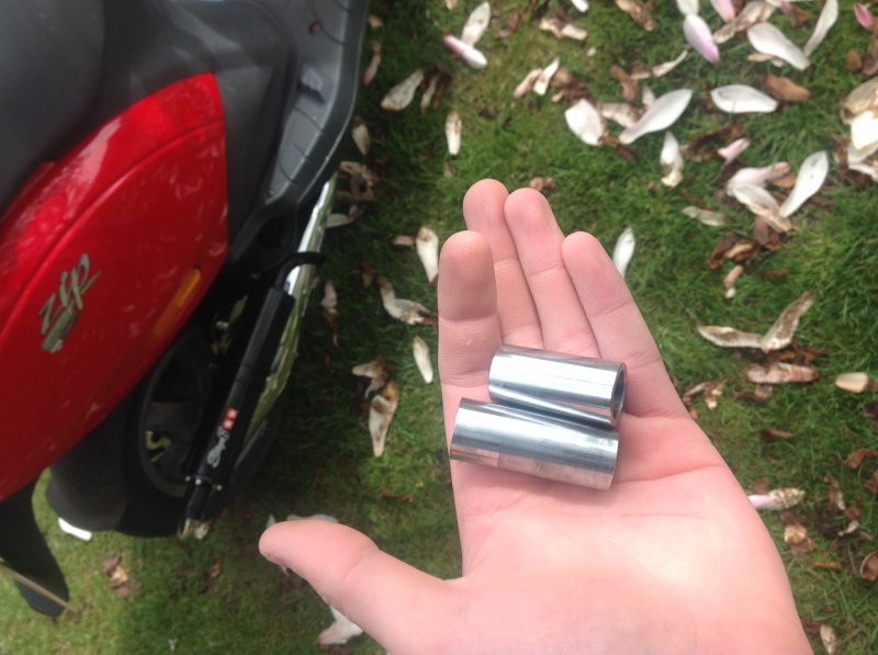

The variator also came with the one on the top (see photo) what one should I be using. The stock one or the one that came with the variator?
kinda large and an inch thick thats not a spacer its an overrange spacer. you will install the stage 6 sliding boss that came with variator install the stage 6 sliding boss , pop on the stage 6 overrange spacer blot it all back down ...... test and come tell us how it is. i have a funny feeling its either a overrange spacer or it maybe a restictor. but i hedge my bet on it being overrange spacer
measure those ring spacers. if they are the same Outer diamiter of the variator sliding boss they are overdrive rings, if one fits over the sliding boss its a restictor and restricts the bikes speed output.
Guys I've sorted it, there was a little spacer at the back behind the variator that was on from stick, I just had to take it off, thanks for your help but it's all running now!!! Thanks guys
