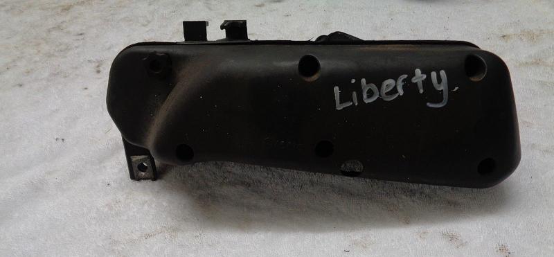

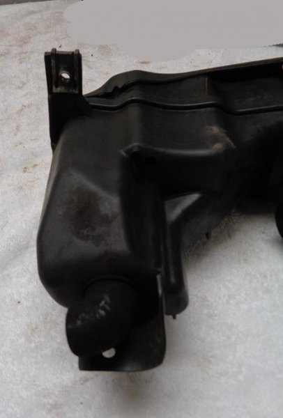

yeah, I blocked off the one from the engine with some sponge which still allowed the transmission to breathe and cool, it was a catalytic system that ran from a junction in the exhaust downpipe, but most people remove it when fitting a new exhaust as all aftermarket exhausts don't have the junction. The tube from the cylinder cover would have went to a carb cover and would have helped cool the carb mine doesn't have this either as I was constantly working on the carb during the rebuild and I have it running good now (if its not broke don't fix it ) so its still in the shed. the rubber elbow I think you mean is the air intake, although mine is on the outside of the box, my airbox is like this one and the tube is at the back it restricts the airflow to the carb to a level the carb can cope with, I took it out once as a test to see if the system would benefit from more air, but it was too weak a mix to accelerate.
Thanks again CGC, That has certainly covered all my queries, I can see that you know your way around Zips. My exhaust is quite battered and there is definitely no junctions from the down pipe. I'll also try a bit of sponge in the end of the pipe, as you have, should help keep any dirt out. I get the message about tube from the cylinder cover. Oops air intake, should have realised that. Yes, my air box is very similar so following you advice I will leave it alone. Sorry if I am being a pain in the butt with my questions but scoots are new to me and the more I can find out the greater my confidence. I also really enjoy researching and understanding how things work as it makes it easier to fix, if necessary.
