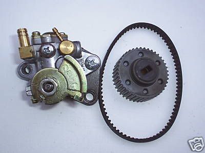

    As i am re-building my typhoon, i have come across a wire and do not have a clue where it goes can u help me out i have pictures below of the wire..
    This is what the wire is attached to below..
    If you could help me out id appreciate it alot,...

    im pretty sure that, that cable is the oil pump cable
  3. m1ck_t
    yep, just bellow your variator, 2 sec jobby mate

    sorry to steal this post a minute, but has anyone got a picture of how the cable connects to the pump as i'm going to be doing it soon and when i got the engine no cable was connected so i don't have a clue.

  5. RY4N172
    it goes through the cases and connects on to a sort of hinge thing
    its pretty simple mate.
  6. typh70
    typh70 New Member
    592
    there will be an adjuster on the outside of the case take the wire through there and it will hook around a gold pulley thing simple and just adjust to ur needs

    sorry to be a noob but where can i get the bit that the cable connects too?

    Yea it is the oil pump, anybody have 1 for sale ??? PM me the details etc..
