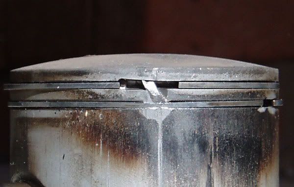

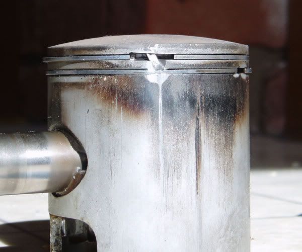

    The SR is finally running again with new piston, rings and slightly modded barrel. YAY. now the weather has gone shit. :(
    anyway, heres a couple of pics of the damage:
    I blame VE, if they had sent me my piston kit when it was orderedthen this wouldn't have happened and my barrel would have survived.

    blimey. is that a bit of piston going vertical in the groove?

  4. wobbly_trials
    it's the end of the top ring that has broken off and become part of the piston

    I had a 250 Suzuki where the rings did that one day. One piece of a ring snapped off and turned round into a port, seizing the engine instantly.
  7. wobbly_trials
    i had a simelar thing with my rs125, the powervalve dropped into the barrel at 10,000 rpm. made a mess, sliced the piston in 2
