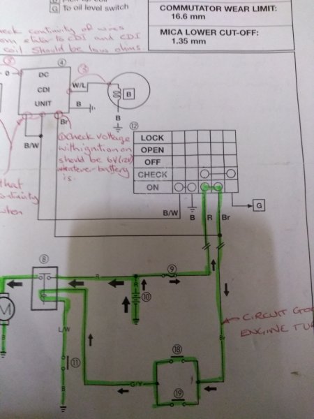

    New plug, new coil, new HT lead, new plug cap, new stator, new CDI.
    Battery is ok, voltage around 12.5ish. Fuse is fine.
    Full continuity on all wiring in ignition circuit. All parts tested for correct resistance. Pick up coil gap as per manual.
    I'm no sparky but I can read a circuit diagram and watch Youtube.
    What have missed? Any suggestions gratefully received!

    I still suspect the main switch might be involved. Can I bypass it safely by clipping brown to red and black to b/w at the connector? Does the grey need to be connected to red too ? (Remember, I'm still not a sparky! :))

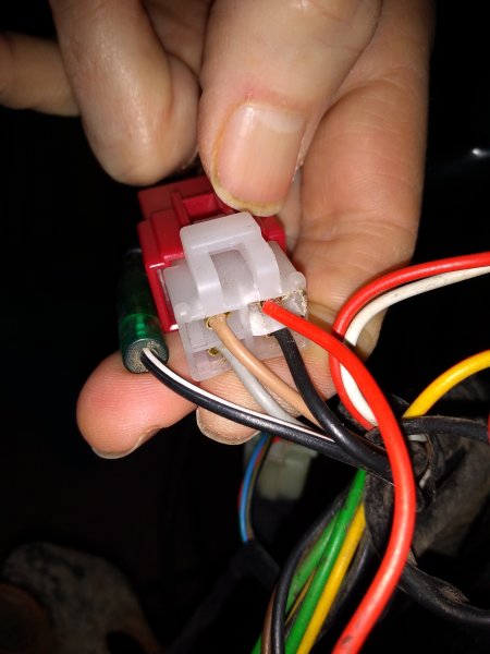

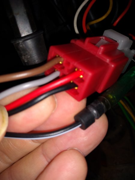

    Ok, so I reluctantly bought a new switch set (seems a bit more robust than the old anyway). Plugged it in and still nothing.
    Then I noticed this.
    The red connection is the new switch (identical to the old). The white one is the loom.
    Check out the position of each colour wire
    . Could this be the problem? The oil light does not come on in the 'check'' position but if you bypass the switch, and cross the grey and red, it lights up.
  10. MLC
    MLC New Member
    10
    Switched the wires around so they match. Still no spark but at least the oil light now flashes on when I turn the key on!
