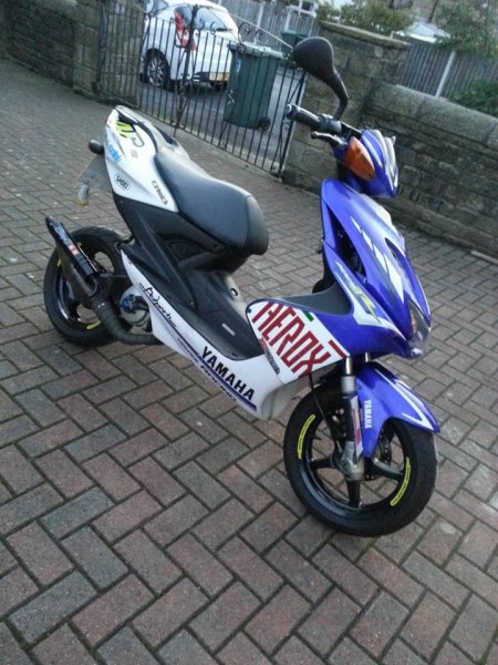

    right this is what i have done to my aerox
    .Polini sport 70cc kit
    .Stage 6 pro exhaust .Stage 6 primary gear up kit .Stage 6 bellhousing .Stage 6 belt .Polini variator .Doppler air filter .upjet from 62 to 94 .malossi 3.7g rollers
    how can i increase acceleration and top speed now?

    Are you running the standard carb?!?! If so you really need to up it to a 19mm or 21mm. Also an adjustable clutch may help pulloff
