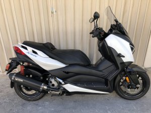

I just put a scorpion ceramic on my '18 300. Xmax......very happy with change in sound. https://www.scorpion-exhausts.com/yamaha-x-max-300-exhaust-systems

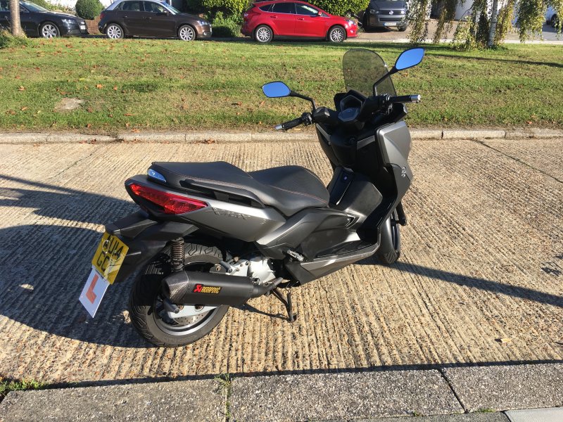

I’ve got the akropovic exhaust on my Xmax 125. I can verify it sounds brilliant but doubt it’s done much else.
