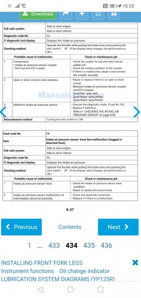

    Hi all I have a 2007 xmax 125, I'm having problems getting it started its getting a good spark a good amount off fuel its got compression but it's showing me fault code 14, iv looked it up and its saying its somthing do with air pressure sensor so I bought a new one and still no joy?

    Hi i dont have a compression tester sorry. I'm thinking it's somthing do with intake pressure sensor as that's the code it showing but iv replaced it and still nothing.

    Yes MAF sensor is all connected up, I'm guessing it has somthing to do with the engine management light that's flashing, I know that the flashing means that's its fault code 14
