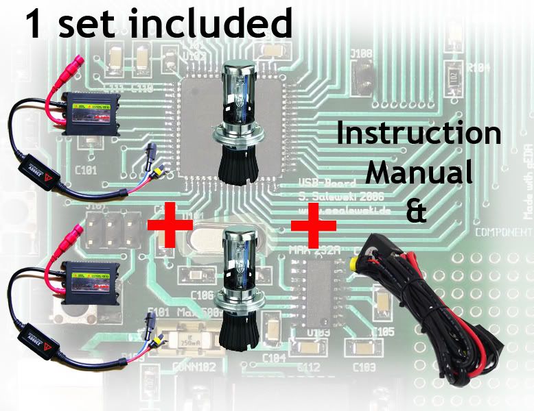

    DELIVERY
    The xenon light system consists of:
    - 1 xenon burner (bulb)
    - 1 Electronic Ballast
    (Very small 12x60x70mm)
    - Cable - sentence Fixings
    (Extra long cables for motorcycle)
    - 1 Hi / Lo control for switching the
    responsibility between mainline and low beam is.
    - Instructions sketches
