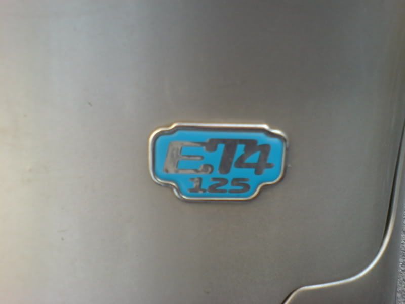

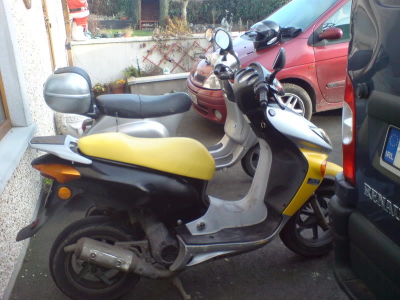

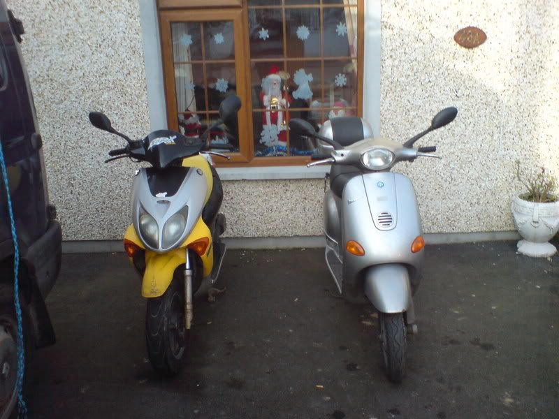

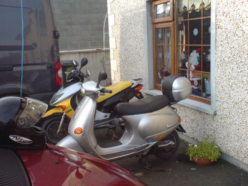

    thread is a bit useless now ive upgraded :w00t:
