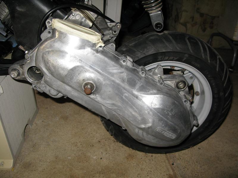

  7. grantmc3
    grantmc3 Member
    409
    piaggio nrg mc3
    its the same engine cover as this , its the on on ebay

  9. tErr0
    Pretty sure thats the old as fook one.
