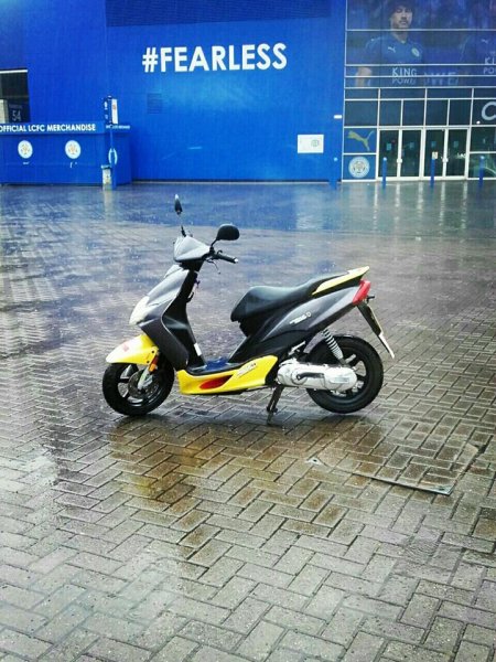

    After my Yamaha Jog RR seized up and I was told it'd need a new cylinder kit I went out and got it all on, changing the fuse and then I decided to change the oil pump at the same time. The kickstart now moves as it should... all sounds fine but the damn thing wont start!
    It wants to, you can be sure of that on listening!
    I've removed the new plug and it's bone dry, i've put some oil down there and it's still refusing to start for me.
    Can anyone give me some advice with this?
    She's a lovely bike and i'd hate to see her go but at the same time i'm wondering if this is going to be some stupid easy fix and if I do sell imma lose out :(
    Much Appreciated Guys! x
