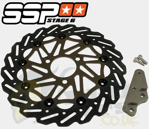

    im shannon from australia and im doing up my 04 aerox now i just bought a stage6 280mm DISC for it and i have a koso guage and it uses the sencer with magnets for the speedo.
    on the stage6 disc theres nowhere to put the magnets theres no holes in the disc the only 3 holes are for the 3 bolts that bolt it onto the rim .
    am i able to glue the magnets onto the rim using a good glue or a silicon ?
    any help or tips would be excellent
    shannon

    My koso clocks they had to drill into the disk and they welded the magnets in, has to stick out about 1mm if i'm correct.

    yes the magnets must stick about 1mm proud, they cant run flush

    so where do the magnet bolts go ?

    thats the same as mine the 3 bolt holes are the ones to bold it to the rim the bigger ones up top are about 15mm holes but no thread just normal holes so any ideas ?
  8. MiNoR cOnFuSiOn
    the magnetic bolts HOLD THE DISK ON :D:D you only need to replace one...
