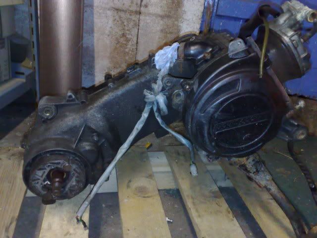

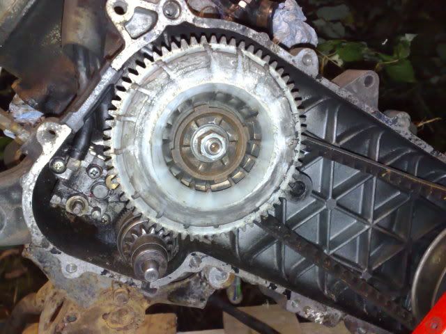

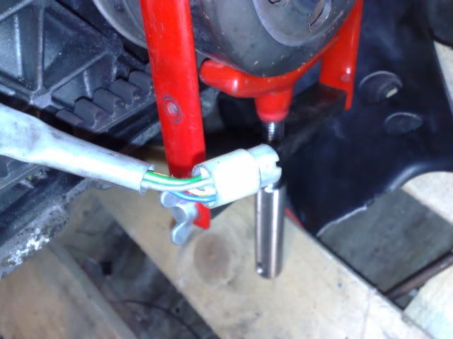

  10. webber
    webber New Member
    37
    heres a few pictures of my piece of shit, needs alot of work as you can see.
    Few problems already,
    1. the clutch nut is rounded off (ideas to getting it off?)
    2. the top left cylinder nut is also rounded off (ideas to getting it off?)
    pics....

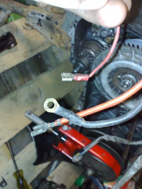

    i oticed in this next pic the red wire is cut, whats it for?
    heres just a quick pic of my bike whilst i'm at it.
    thanks
    webber
  11. jon_w
    jon_w New Member
    171
    Try an impact socket on the clutch nut (tighter fit)
    and molegrips on the cylinder head nut.
    im sure someone here will come up with a creative idea involving welding but try the simple stuff first.
  12. webber
    webber New Member
    37

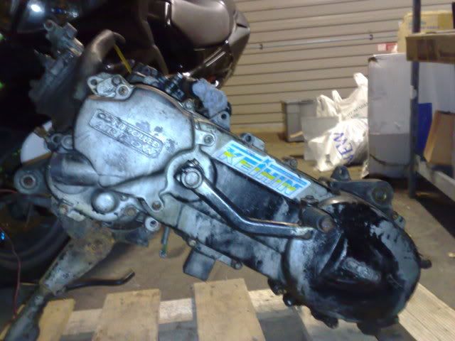

    right, got the nuts off and started to strip the engine down ready to be cleaned.
    I want to really tune this engine, possibly evo 70% - MHR 30% any ideas?
    Also anyone know which engine this is?
    Are the tranny covers all interchangeable?
    Webber
  13. MiNoR cOnFuSiOn
    stud nut you can grind hard at the top then nock a socket back on, or just cut the nut off then remove once the barrels off. clutch ether an impact wrench with a crv socket or a nut splitter to get the nut off

  15. MiNoR cOnFuSiOn
    ye, its the old shape.... carb model obv. only diff is anyhting to do with the gearing, everything off any other piaggio engine wil fit
