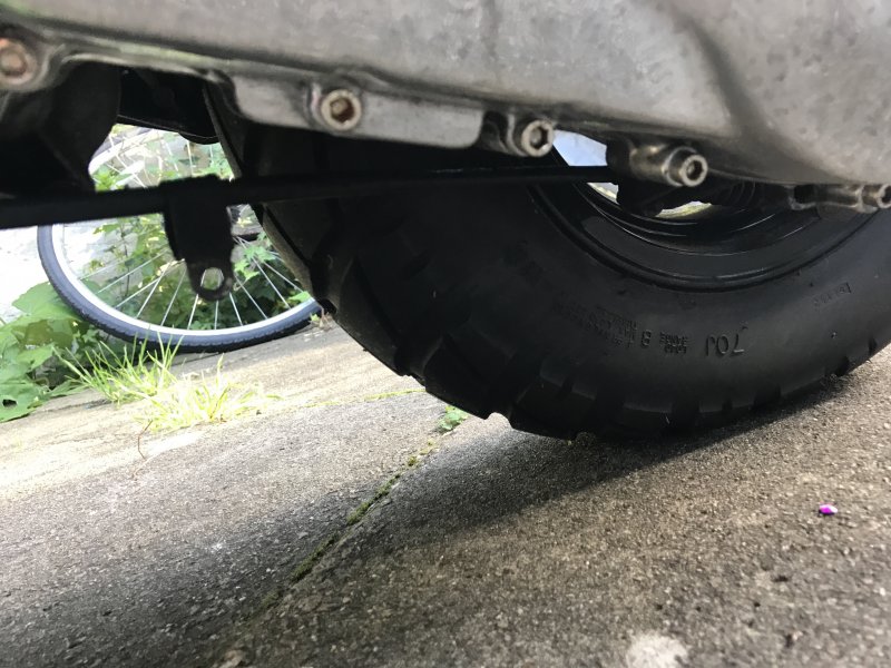

Where does this rear break cable clamp screw on to?

    It's a typh 125 2T. Can't remember where it screws onto.. doesn't seem to be any threaded holes near the rear of the tranny case.

    One of the transmission case bolts.

    Ok thanks. So it sits in between both faces of the case, once the case has been bolted down?
  4. Mark Emerson Trentham
    Take out a bolt,thread cable clamp on - then screw into case.;).

    No, undo any bolt and put bolt through eyelet and tighten up, just like he said upstairs from me !
  6. Mark Emerson Trentham
    Can't tell if the cables under any tension.?,would say no.3 from the left to keep the action straight.:)?

    No tension on the cable. Il fit it later after when I'm home. I know you guys are right but I'm just wondering if doing that leaves the cable slightly tensioned as it seems it'll bring it out of its natural resting position. (Cable being behind engine case and being pulled to the outside to the bolt hole)
