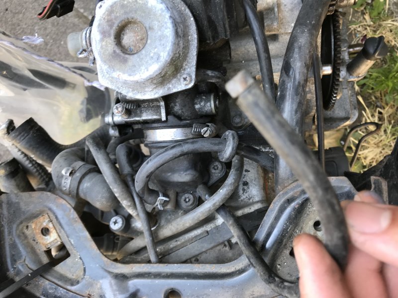

    7F651F12-AB04-4B1B-9ED6-7B4ED2D889B9.jpeg Gilera runner 125 vx
    2 hoses coming from manifold. The one with my hand on, where does this go to. Found it with a bolt stuck in the end.

    Hard to tell but could be a spare vacuum line plugged after the removal of a pair valve or secondary air box or where a vacuum fuel tap was changed out for a free flow one maybe?
    Where is the other end attached?

    One end is coming from the manifold and the other end was just laying freely with a bolt shoved in the end.
    Is there meant to be 2 hoses coming from the manifold on a vx 125?

    446
    Pipes from the manifold suggest a vacuum pipe. This is likely to be from a removed part so now redundant. Possibly have two hoses as they would split for different uses. Used for carbs, fuel taps
