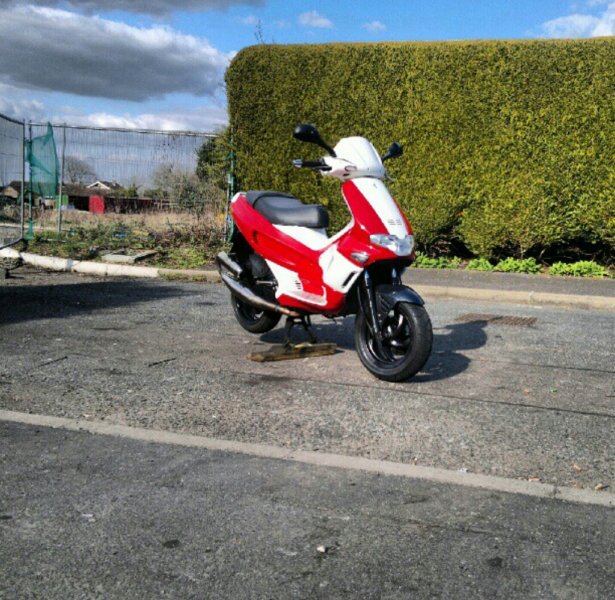

    Ohhh I know it's going to be nippy. I've had a 183 and a 172 runner. Just want something fast and fun for the weekends. If I like this setup I'm going to go for the stage 6rt 70
    Here's one of my old runners
