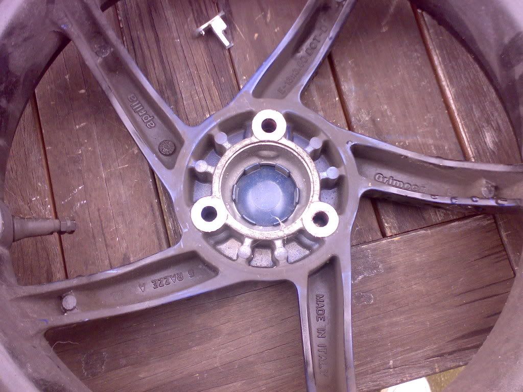

    ok ive got a rear sr50 2005 wheel and wondered what engines it will fit and what wheels will fit onto that engine, its a piaggio engine so im hoping runners, nrgs etc. oh btw its a 13inch wheel too

    Any piaggio engine with 3 studs and a disc brake I would imagine.
  3. MiNoR cOnFuSiOn
    need a diff hub and mabey an output shaft for any other wheel. ALL piggy disk wheels are 5 bolt.

    oh ryt ok so with the right hub would it be ok on a typhoon 125?
    btw its got disc mounts so will be gettin a disc conversion
  5. wobbly_trials
    no it won't fit a typh 125 as thats a drum engine.

    ^^ despite having a new hub and disc conversion?
  7. wobbly_trials
    i don't know of any 125 hub with 3 studs. the usual conversion uses a runner hub which is 5 stud.
    3 stud wheels usually are only on 50s. minarellis and pugs especially.

    ahhhhh ryt i c cheers for the help was hoping to put these left over sr wheels on it what bout sr 125 wheels could i fit them to the typh lump??
  9. wobbly_trials
    yeah, the SR 125 wheels should fit, the 125 has the same front as the 50.
