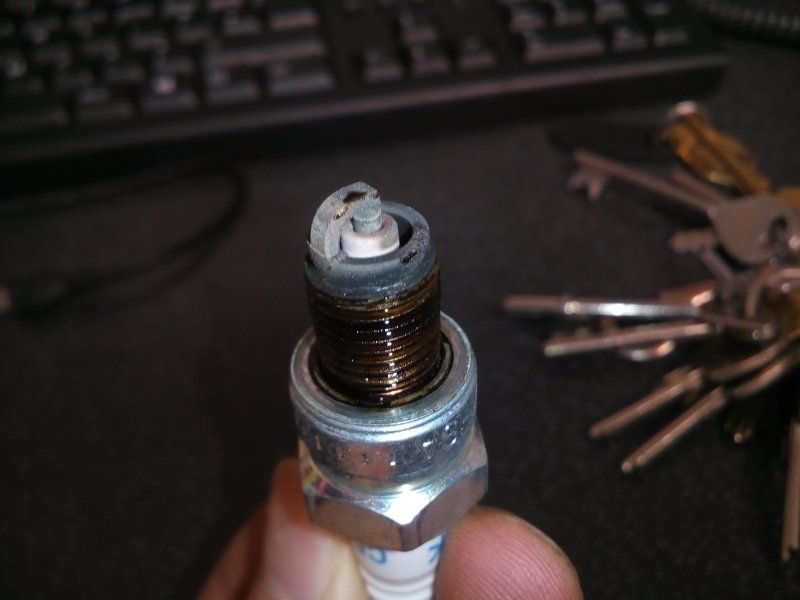

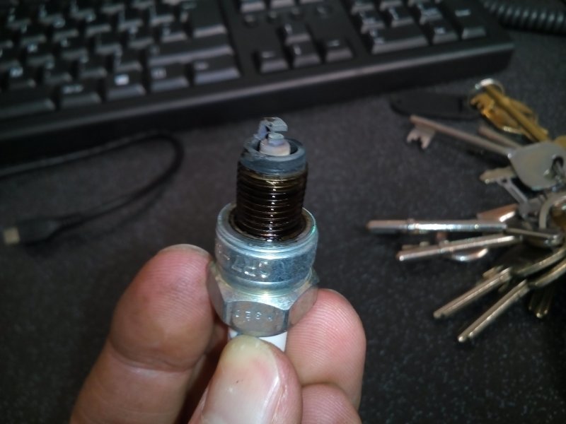

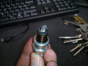

    Just replaced my spark plug, it looks dark and wet to me does that means its running lean?

    Its not the thread you should be looking at but the white ceramic and the point .looking at that it looks very lean
  3. scubabiker
    way too lean.

    534
    How do i fix this then? do i just adjust the idle screw?

    2007 TKR WRC 50
    You need a larger main jet. Does your bike have an aftermarket exhaust on it?
