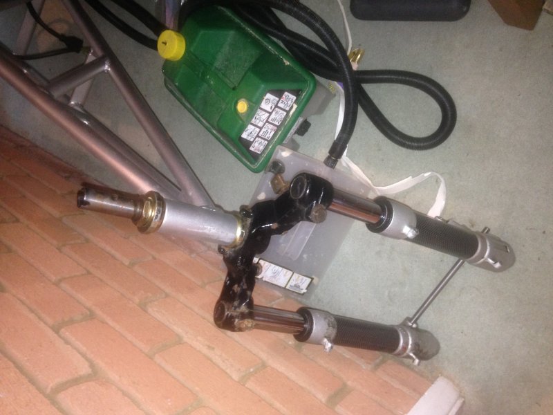

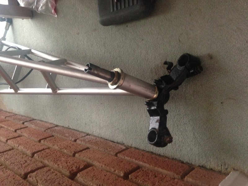

    Forks shortened to fit the fork tube, welded and in :)

    Fork legs are in :)

    Unfortunately none of the runner wheels or the NRG front wheels that I have fit whith the booster forks. One Aerox front wheel purchased from eBay and should be here early next week.
