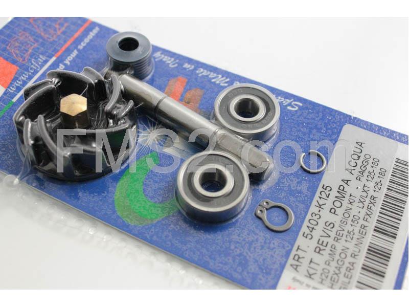

is this okay or the bearings shold be apart?
There should be a spacer between the bearings!
There is no spacer in this repair kit i bought? Any ideas?
Probably use the spacer off the old shaft. I'll look if I have an old one.
