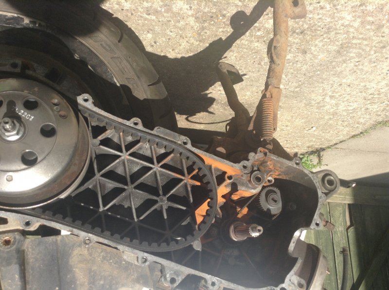

    sorry not been riding 50cc for long so have done the easy stuff (renew belt and a little more challenging replacing a new piston) but this seems a little more complicated as can't seem to get the bottom cog off as that seems where the water is coming from

    Sorry picture upside down

    Yes, water pump seal.

    Thanks for the help so far but I can't even get the gear cog off where the water is leaking from
    Should it just pull off or do I need a special tool to get that off too

    It just pull's off, it's worn and need's a good firm tug as it's corroded on the shaft and jammed.

    If its similar to my gilera then the leak is from the seal where you are looking. The small cog is driven by the variator through a tiny belt which spins a shaft that has an impeller (waterwheel) on the other end.
    As already said the cog should pull off but I would get a toothbrush in there to clean it up and check for a snap ring just in case.
    The shaft runs through the engine to the other side where the impeller is sat inside the water channel within the engine. You need to find the cover and remove it to expose the other end of the shaft.
    Buy a water pump repair kit which has the new seals and then Google or Haynes how to replace them.
    Mine was corroded so I had to drop the engine and split it to access the whole system as I couldn't get the old seals out. If you are lucky then it can be repaired in situ by removing the old seals and knocking in the new.
