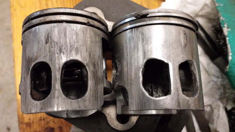

OK had another go today took the top end off and matched the new pistons windows to the Nakaru old piston as were a lot smaller , diy honed the bore which had some small scores so they all gone now , compression wasn't any better , maybe worse now but is improving the more I run it , had the stator off to check seals , all ok , and found oil pump wasn't driving correctly that's why it seized , was loose so tightened and all good , I'm back on oil pump now I had a good look at the carb , and the pilot jet hole into the carb seemed tiny , I have some micro drill bits and drilled the hole a bit bigger my bottom end power is back , enough to pull out with confidence , Probably my pre mix wasn't getting though there , I drilled a pilot jet bigger but it made the bike run like it's on choke , but lucky I had a spare old carb to rob from , back on standard pilot jet I had my carbon reed s out and have tried to make them close fully with little success , I didn't tighten them up so much and applied Loctite to the screws was better , but I'm getting misfiling in the exhaust , popping sound ,not every time , but I'm putting it down to that , going to have a look at them in a bit , either that or I'm over fuelling and mixtures backing in the pipe - 88 main jet anyway I'm going to try the reeds again , hopefully I can ride enough to get a plug colour , but yey back riding 3 days work tho

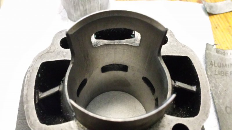

My new Barrel and piston arrived , Smoothed of the sharp edges on ports , checked ring gap to 015 fitted on no dramas apart from the usual gudeon pin clips .. Its running nice quiet engine wise , I repacked the tecnigas can and it's nice and quiet the plug was a nice choc brown , and I haven't had any more seizures looking forward to put some miles on it hope the flat spot has gone , then I'm going to sell it had a bit of a gut wrencher , which bike to keep But Ive decided im going to be riding an MC3 AC 70cc NRG , just got it going properly gotta get an MOT and a new petcock recon its a better bet for my tuning project off topic tho
